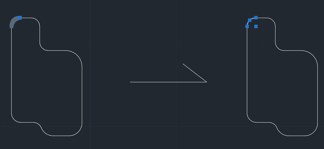

hello
I've searched a lot of Lisps, but there isn't one that has the function I'm looking for, so I'm asking this question...
I wish the numerous lines would turn into one arc.
I will upload example photos and files.
Thank you for your help.

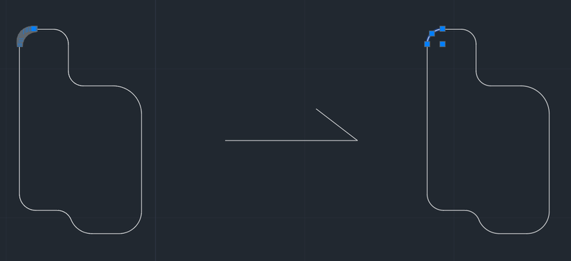

image.thumb.png.c766505fb8211959ad9520a0b69d098b.pngimage.png.9048e2e8e602f02a68b4871ce46e8a54.png
I want to change this collection of straight lines into an arc.
A lot of time was spent working on these arcs.
I'm looking for Lisp.

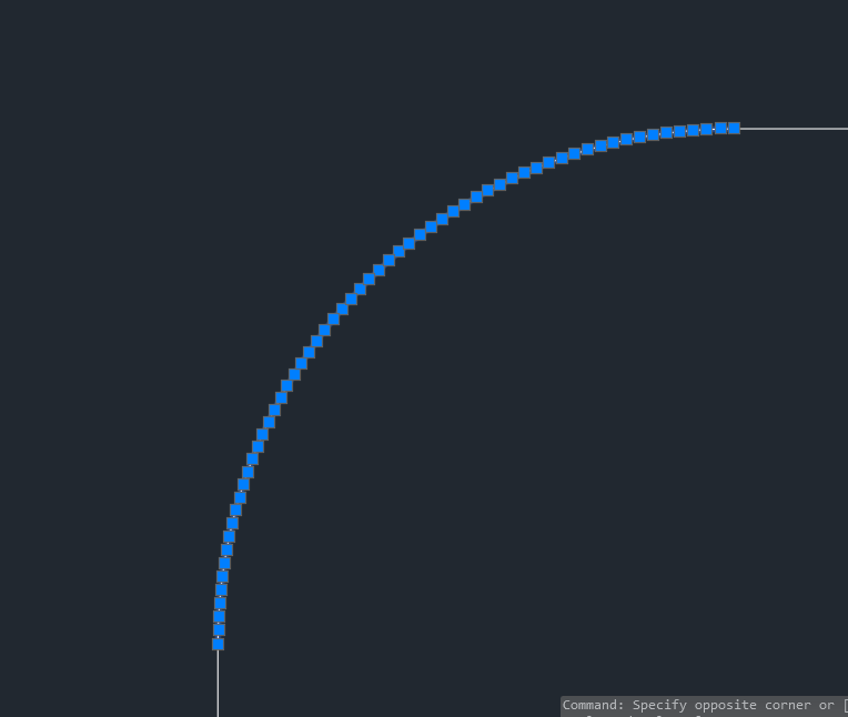

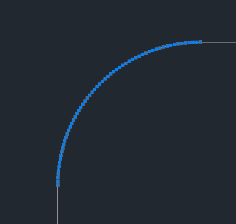

From the quick look I did all the lines in the arcs are the same length, 120 segments to a circle, 30 to a quarter circle. If so then "end point" could be found from that?
Just wondering, list all the segment start and end points and the end of the arc there will only be 1 point listed - all the others have 2 points listed, one from each adjacent segment? This should return the end points of lines that are touching. Maybe needs some factor in case they arn't all touching exactly
