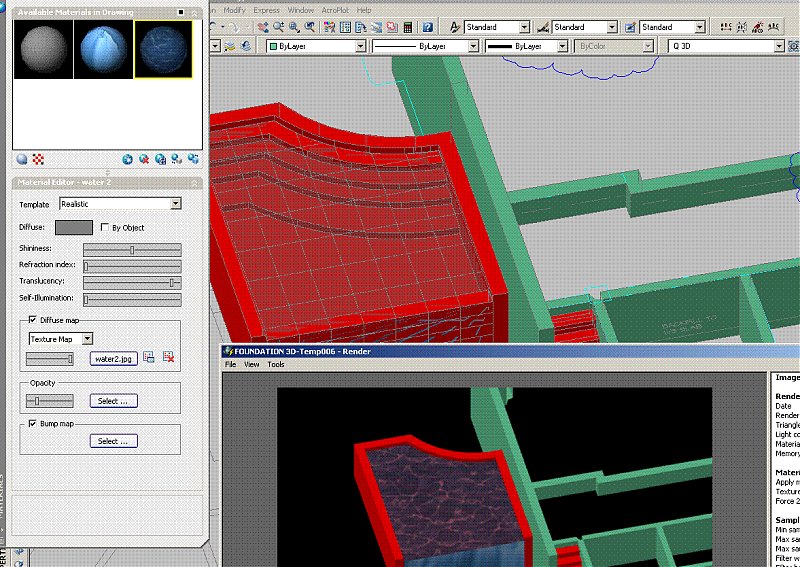

qball Posted March 2, 2009 Posted March 2, 2009 instead of starting a new thread, I thought I'd just add on to this one. Attached is my screen shot of a pool, with the rendered image below. I used RMAT, and a jpeg image that I googled. I'm trying to make the water transparent so I can see the stairs. The rendered image doesn't show it. As you can see I used the Opacity bar on the Materials window. Quote
Cad64 Posted March 2, 2009 Posted March 2, 2009 Try switching to the "Water" template instead of "Realistic" Load up your water image as the Diffuse Texture Map Leave Opacity set to 0 Bump up self-illumination, maybe somewhere around 30 Render again Quote
