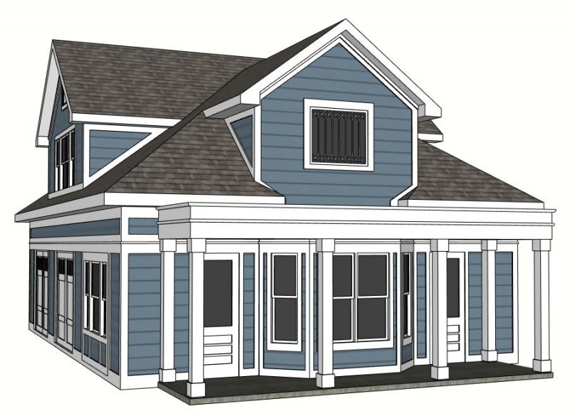

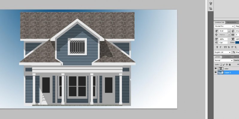

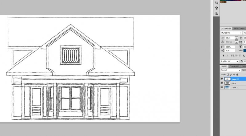

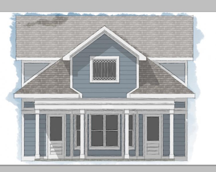

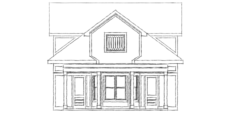

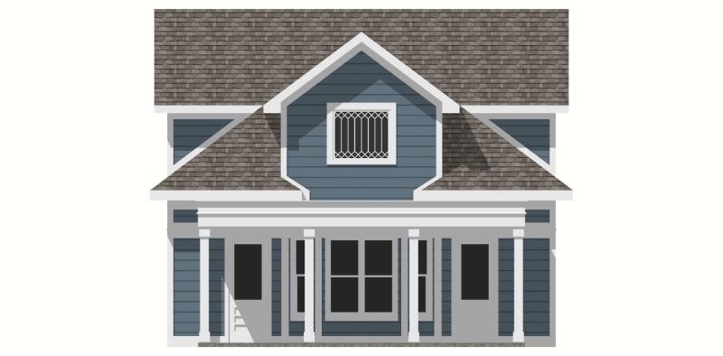

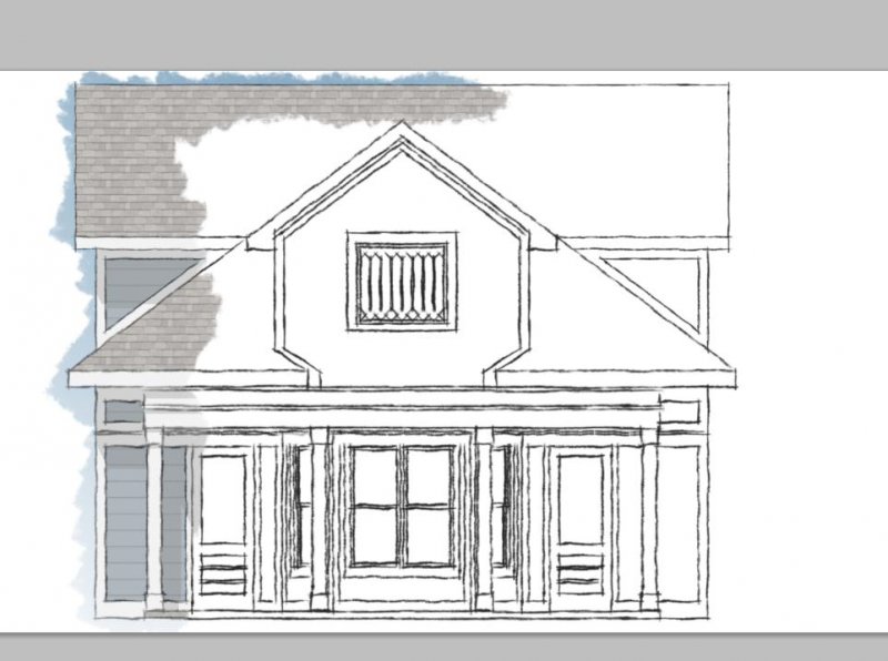

f700es Posted January 24, 2014 Posted January 24, 2014 OK, here we go. 1st you have to have a 3D model of the building you want to render. I use Sketchup as it gives me the different styles I'll use to get this look. So we start with our 3D model with textures applied. Next I set a "flat" 2d view of the side I want to use. Set your camera to parallel and view to front in SU. I also turned the shadows on and the edges off. We export a 2D image of this view Next I apply a sketchy style of just lines and no textures. We do not change the view as we want it to be the exact same size. We then export this view. Next we move to Photoshop. I start with the color view. I open it and set a empty layer under the color layer. In the color layer I use the magic wand tool and select all of the white and delete it. In the bottom layer I apply a color gradient to represent the background sky. Next I add another layer, above the color layer and bring in the sketchy image. Now I select the eraser tool and pick a brush that has some type of texture to it. I scale the brush up till I get a nice size, about 115 or so. I also set the eraser opacity and flow to about 50% as we only want to lightly remove the sketchy image. And we start erasing the sketchy image. When you start do not let up on the mouse button as this will add another layer of eraser to the image. You want the 1st pass to be a uniform as possible. After the 1st pass on the entire image I make another pass on the foreground items in the drawing, this makes them stand out a bit. There we go. With some trial and error you can add some different effects or maybe even add some landscaping items. Like the trees I have in the original image at the start of the thread. This is an old technique but still a good one to know. Quote
tzframpton Posted January 24, 2014 Posted January 24, 2014 Two thumbs up, f700!! Awesome tutorial. Quote
