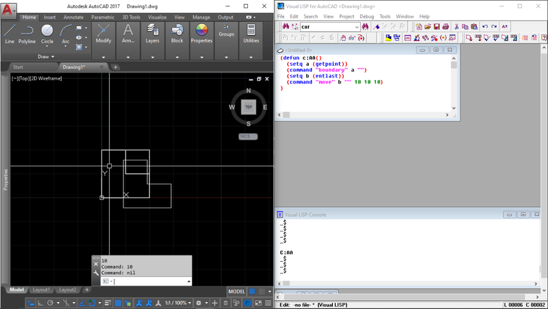

How do I insert a newly created object using command syntax (in my case, I used boundary command) into a variable in AutoLISP?
If that's the last entity created by AutoCAD, it can be referred using ENTLAST.

I tried previously with ENTLAST but it does not work. So I have this configuration of bigger rectangle and smaller rectangle created sequentially. I made a function that can execute boundary command and, like you said, confirm it with entlast, but the one that moves is the smaller rectangle because it is the lastly created object in AutoCAD, whereas I want to move the object created with AutoLISP instead. Do you know how to fix this?
My try:
(defun c:pp()
  (command "boundary" pause "")
  (command "move" (entlast) "" (list 10 0) "")
Still does not work...
It's like the command boundary and command move entlast execute at the same time

I just did a workaround
I recently found out that boundary command can be executed multiple times.
So I set up a variable first rather than executing it directly in command syntax.
What do you think?
