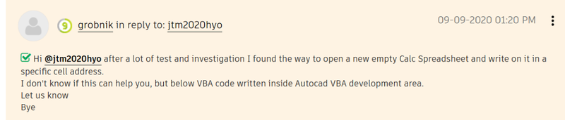

I still do not believe LISP is the best approach for AutoCAD. Autodesk seems to want only MS Office products accessible, a BricsCAD solution would still be nice.
When I can get back to working on programming, I am still going to look at a VBA, Python and/or C# solution. I might give LISP one more try.
I may have posted this, but any way. Calc Macros   Calc API overview.

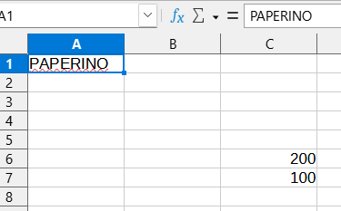

I found out that Libreoffice files are compressed in zip and that the contents of the tables are saved in an xml called 'content.xml'
@SLW210 the code posted was tested in Bricscad V24.
