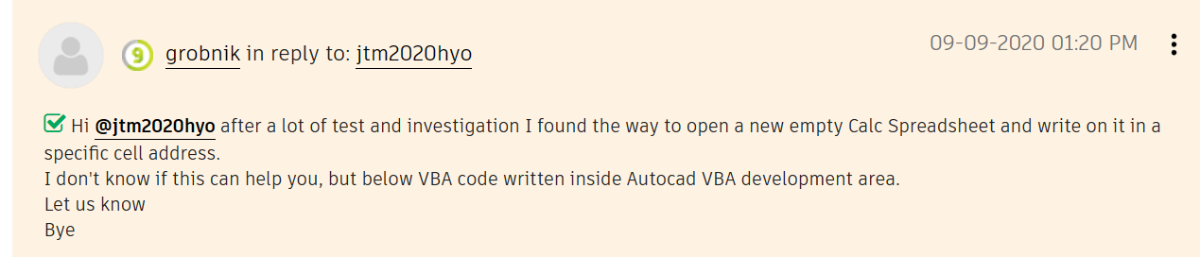

Well this works for put cells try this using VBA in Acad or Bricscad. Opens a blank document and puts some values so a big success.
Sub Main()
    'VARIABLES:
        Dim obL_Service_Manager As Object
        Dim obL_Core_Reflection As Object
        Dim obL_Desktop As Object
        Dim srL_Url As String
        Dim obL_Calc_Document As Object
        Dim obL_Sheet As Object
        Dim obL_Range_First_Column As Object
        Dim obL_Range_ToSort As Object
        Dim a1L_Arguments()
        Dim lnL_iLast_Row As Long
        Dim lnL_iLast_Column As Long
    'PROCESS:
        Set obL_Service_Manager = CreateObject("com.sun.star.ServiceManager")
        Set obL_Core_Reflection = obL_Service_Manager.createInstance("com.sun.star.reflection.CoreReflection")
        Set obL_Desktop = obL_Service_Manager.createInstance("com.sun.star.frame.Desktop")
        srL_Url = "private:factory/scalc"
        Set obL_Calc_Document = obL_Desktop.loadComponentFromURL(srL_Url, "_blank", 0, a1L_Arguments)
        Set obL_Sheet = obL_Calc_Document.Sheets.getByIndex(0)
        obL_Sheet.getCellRangeByName("A1").String = "PAPERINO"
      obL_Sheet.getCellRangeByName("C6").Value = 200
      obL_Sheet.getCellRangeByName("C7").Value = 100
      End Sub
