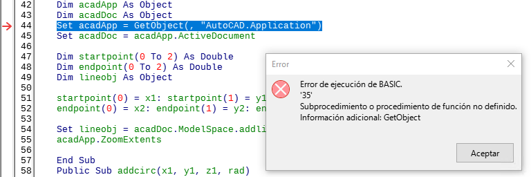

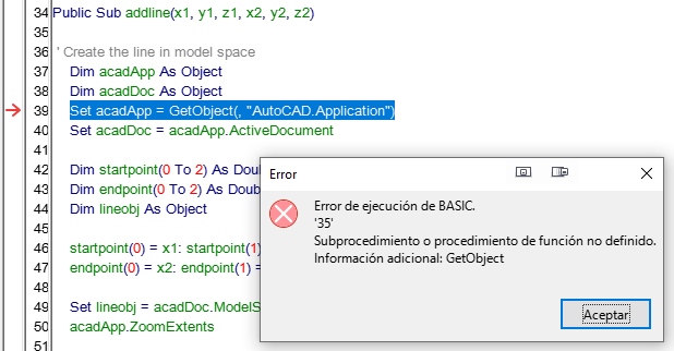

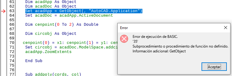

Truski Posted February 7, 2024 Author Posted February 7, 2024 I have tried what you have passed in LibreOffice and it gives error (attached images). Quote
Steven P Posted February 7, 2024 Posted February 7, 2024 I am not up to speed with that but in the (, "AutoCAD. Application") line the ',' looks odd and out of place as if there is something missing before it or it shouldn't be there? Quote
BIGAL Posted February 8, 2024 Posted February 8, 2024 It looks like Librecad calc does not support "get Application". Remove all the Line arc pline code and only leave the open dwg macro and try again. Similar problem with LT 2024 does not support Get Application. I googled "Contact Libreoffice" and got some where quickly, but needed to make an account, so stopped, as your a user you can ask about Libreoffice and Autocad interactivity if possible, or post the get application line asking can this be done. Then let us know. Quote
