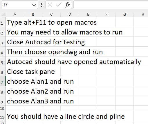

BIGAL Posted February 6, 2024 Posted February 6, 2024 No worries if you can chase up Libreoffice to see about using .Application would be helpful towards a direct link to excel. This will draw objects in CAD from excel, try it with your libreoffice calc.draw object xl acad.xlsm Quote
