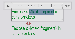

Is it possible to enclose a text fragment in brackets?
That is, go to the text editor, select a fragment, enclose it in brackets...

{MText MText  MText}
But you won't be able to add it to @Isaac26a code, where there is a choice of the type of brackets.
