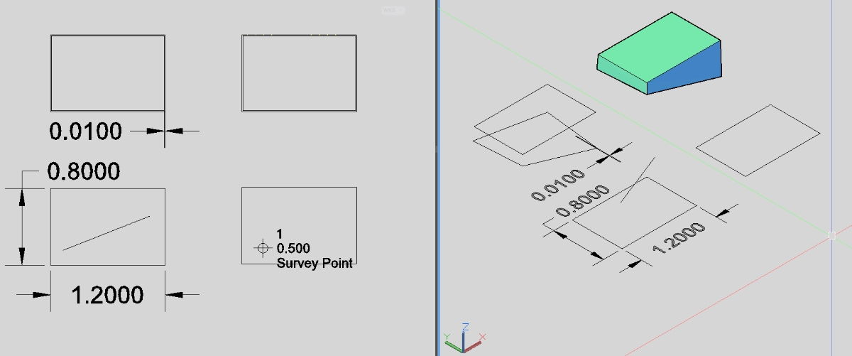

I made a sample drawing which shows what I am trying to do.
I have two possible scenarios:
  1. A closed 3D Polyline at the bottom and a 3D Polyline above
  2. A closed 3D Polyline at the bottom and a Survey Point above
With those two scenarios I use the Civil 3D command OFFSETFEATURE (which is a step-by-step 3D offset procedure).
How the command works:
  1. Specify XY-offset distance
  2. Select Object to offset
  3. Specify Side of the Object where the offset should be placed
  4. Specify Z-offset distance which may be:
    1. elevation difference
    2. constant height
    3. ...

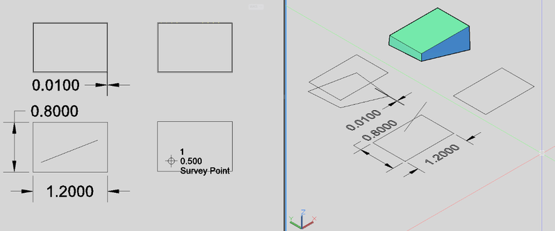

Civil 3D OFFSETFEATURE command
The problem is step 4. where i have to input the Z-offset. At this point I cannot pick a coordinate, but only enter a single value.
I have to type in the value by hand, so I need to memorize the value, copy it from the properties pane or write it down on a paper.
Here an customized AutoLISP command would come in handy.
I thought of "modifying" the OFFSETFEATURE command in a way that at step 4. I could either pick a point on a 3D Polyline or a Survey Point.
Now what I need in the end is a TIN Civil 3D Surface, therefore the upper 3D Polyline must be located inside (when looking from the top) the lower 3D Polyline to create a 3D Mesh without Errors.
Drawing_C3D_sample001.dwgFetching info...
