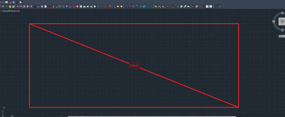

Hello friends, Could you please add the code that centers the input information (mtext) from the keyboard in the code below? Like middle centre of mtext at the accrossing line cause now it is automaticallt top left.

Hello Beyza, welcome in the forum!
I tried to run the program you posted, but it ends with an error, it says " no function definition: VLA-PUT-BORDERSTYLE"
I won't start debugging the code, but if you wish to change the justification of an Mtext, insert this code right after the creation of that Mtext
(entmod (setq el (entget (entlast)) el (subst '(71 . 5) (assoc 71 el) el)))
I'd be tempted to create the mtext using entmake or entmakex, looks like you are creating mtext and then modifying it - entmake should let you do all of that in one step.
If you create an mtext set with the colours, background and so on that you want to use and use (entget(car(Entsel))) this will give you the dxf codes to entmake the text, background masks need 90, 63, 45, and 441 in addition to the usual formatting
I'd have to do some reading how to add a mtext border, not sure if it is part of the text definition or needs to be a separate entity
(defun c:wapeningstype ()
  (command "_.RECTANG" "_W" "50" startPoint endPoint)
  (setq startPoint (getpoint "\nSelect the first point of the rectangle: "))
  (setq endPoint (getcorner startPoint "\nSelect the other corner of the rectangle: "))
  ; Create a rectangle using the selected points
  (command "_.RECTANGLE" startPoint endPoint)
  ; Set color of the rectangle to color 1
  (vla-put-color (vlax-ename->vla-object (entlast)) 1)
  ; Get the corners of the rectangle
  (setq lowerLeftCorner startPoint)
  (setq upperRightCorner endPoint)
  ; Create a polyline from the corners of the rectangle
  (command "_.PLINE" lowerLeftCorner upperRightCorner "")
  ; Set color of the polyline to color 1
  ; Calculate the midpoint of the polyline
  (setq polylineMidPoint (polar lowerLeftCorner (angle lowerLeftCorner upperRightCorner) (/ (distance lowerLeftCorner upperRightCorner) 2.0)))
  ; Prompt the user to enter information
  (setq userInput (getstring "\nEnter the information: "))
   (entmakex (list
     (cons 0   "MTEXT")
     (cons 100 "AcDbEntity")
     (cons 100 "AcDbMText")
     (cons 10 polylineMidPoint)
     (cons 40 200)
     (cons 71 5)
     (cons 72 5)
     (cons 1 userInput)
     (cons 73 1)
     (cons 90 17)
     (cons 63 1)
     (cons 45 1)
     (cons 441 0)
