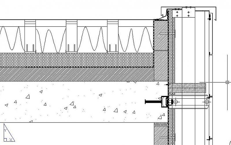

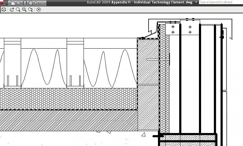

Hello,
I thought i was getting used to CAD but when printing my lineweights continue to be all messed up:?. I have set the lineweight to default but the drawings are still coming out with thick lines, i think the components in question i initially decided to try and play with the lineweights, but was since told by lecturer not to and give my drawings some finesse.
HELP please! this is aweful
Thanks in Advance:)

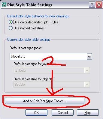

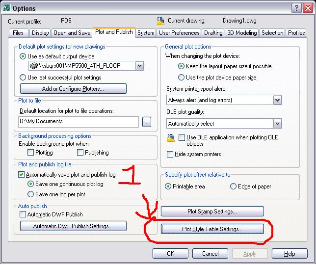

1. Go TOOLS>OPTIONS and into the PLOT and Publish tab and click
on the button I've highlighted.
2. On the pop-up dialogue box click on the second button I've
highlighted.
once done you should get a window pop-up where your .ctb files are
stored, make a COPY of one of your defaults, double click on the
copy and then edit it as rqd.

good god why is this so difficult, i have been trying the above advice for hours now, changed all my lineweights to 0.05mm, colors all to 250 (black) and am still getting grey, thick aweful monsters. Made my self a new plot style but have been trying to avoid using them altogether maybe i will try re-drawing all the lines, never had this problem before, as far as possible i have been setting the plot settings to go by layer and still no hope, i just dont under stand
