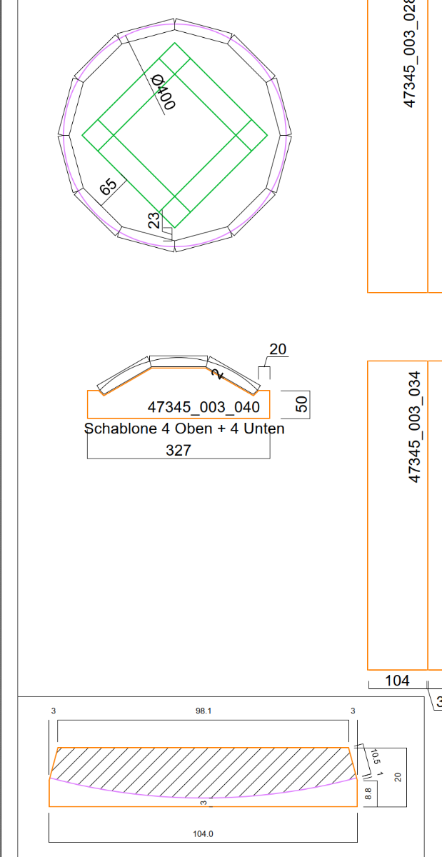

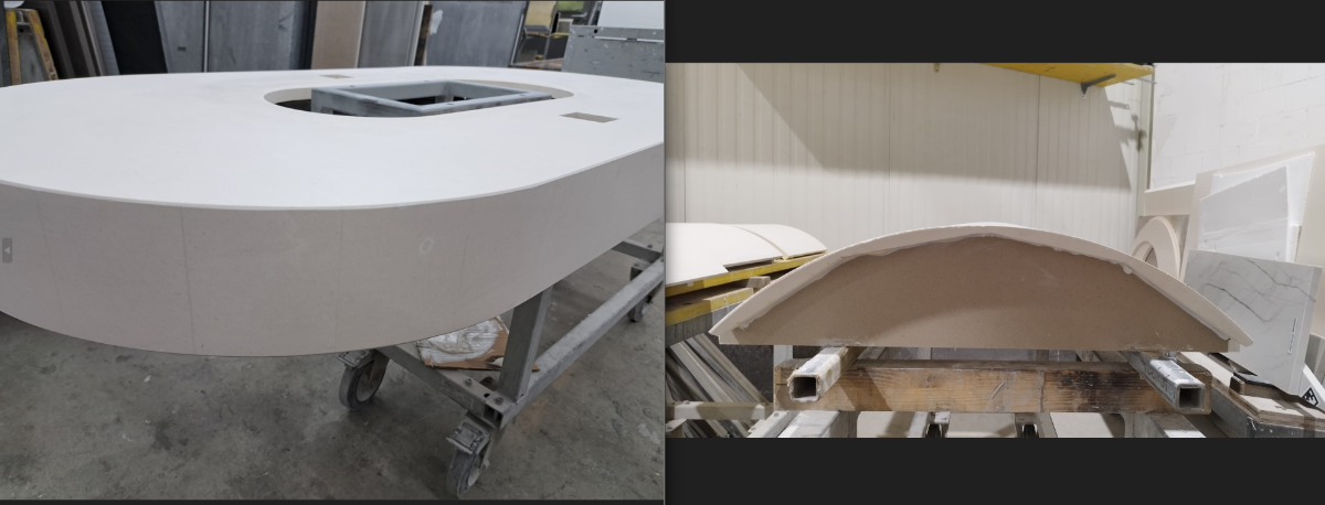

Hello everyone. I am trying to write a program to automate the process of drawing stone segment coverings. It is labour intensive and prone to errors when done by hand. Everything is actually just mathematical calculations, so it is just fine for the LISP to draw it.
I got to a certain level of code that asks for user input of circle radius, stone thickness, calculates the minimum amount of segment that will fit within our production tolerances and creates each individual segment piece accordingly. I manage to calculate and increase the number of segment pieces to an even number when the simplest connection height for the segment template exceeds 150+50mm that we have.
My second step, which I am currently stuck on, is to create the bottom of the template. This is a 2mm offset from the inner lines of the segment pieces, I cannot wrap my head around this and locate points with the polar command I used to create the segment pieces.
I think it would be better to create another function for the template piece, but I cannot calculate the offset intersection points of the segment poly line using basic trigonometry as I used to calculate individual segment piece points and rotate them according to angle and polar function.
Any help would be greatly appreciated.
