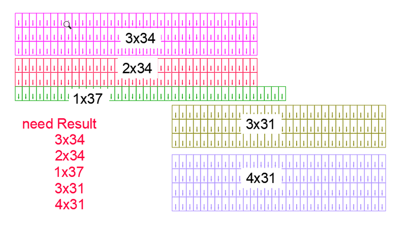

Here is an example of an array that needs to be worked on and I need an easy way to count the number of rows and columns. For example, I have 3 rows and 20 columns and I need to be able to select for multiple arrays.
For example, if 10 arrays with different row and column counts are used and I select all the arrays, I need to know the individual row and column count of all 10 arrays.

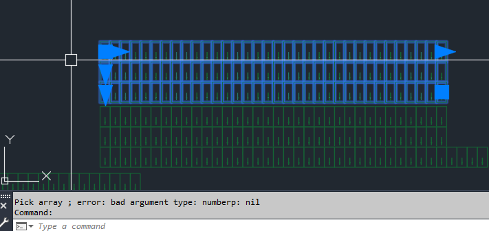

@BIGAL Thanks  but not work for this code  below the image shows up after the WOw comment
@mrharris78 Thanks, as per the code just show only the total count array number

@mrharris78 Amazing code, but I need the results to look like the image 01 below. According to your code, the selection array should show up as image 02 below.
image 01
Image 02
Tamim, I have updated code above - not tested and no error checking.
