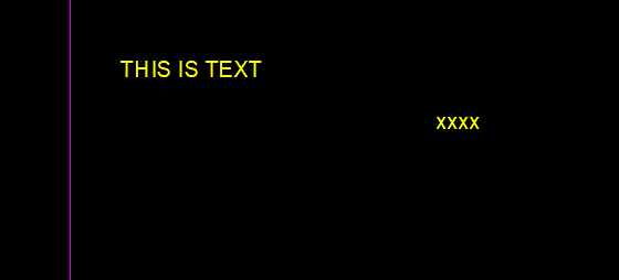

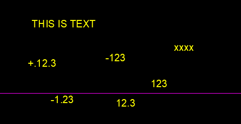

pkenewell Posted May 13 Share Posted May 13 (edited) 11 minutes ago, Highvoltage said: Thanks, but it does the same. It hides every text layer. No matter what i write for the wcmatch. Strange - it's working fine in the document I tested. Did you test my changes to mhupp's code? Do you have a drawing for me to test? EDIT: Here is another slight update. I realized I did not add the decimal point to the search. It is still working good for me, testing different MTEXTs with "+" "-" and decimals in the numbers. HideTextwNumbers.lsp Before: After: Edited May 13 by pkenewell Quote Link to comment Share on other sites More sharing options...

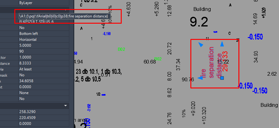

Highvoltage Posted May 13 Author Share Posted May 13 I think part of the problem is, that the content of the text is formatted, and therefore it will find numbers in every single instance 1 Quote Link to comment Share on other sites More sharing options...

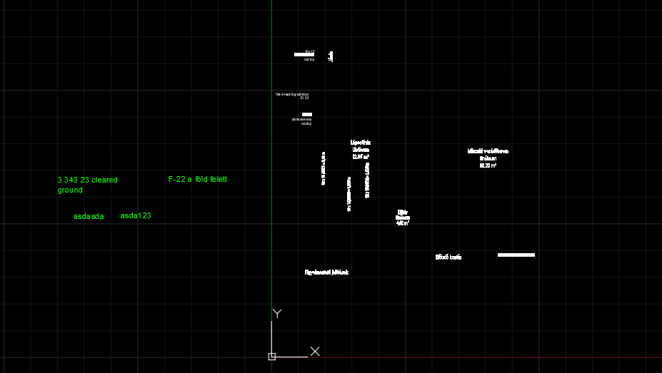

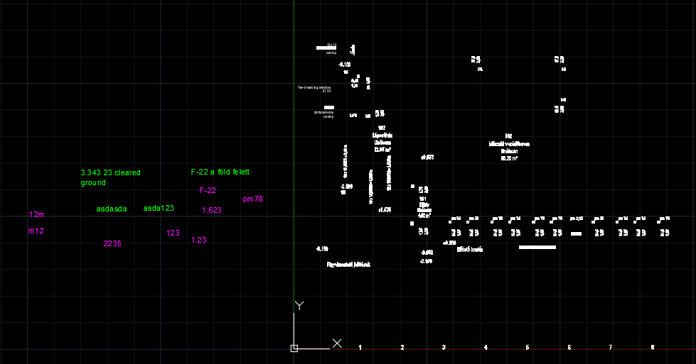

pkenewell Posted May 14 Share Posted May 14 (edited) @Highvoltage OK - Here is my update to mhupp's code using regex, along with Lee Mac's code to remove formatting from the comparison. This does selectively hide MTEXT items based on your rules. But you will need to again, adjust the regex pattern to suit. **EDIT - I tweaked the pattern again to get more things, like a unit string on the end or % symbol, and spaces between. It could still be tweaked more, but I don't know exactly what your threshold is. Before: After: HideTextwNumbers.lsp Edited May 14 by pkenewell Quote Link to comment Share on other sites More sharing options...
Highvoltage Posted May 14 Author Share Posted May 14 1 hour ago, pkenewell said: OK - Here is my update to mhupp's code using regex, along with Lee Mac's code to remove formatting from the comparison. This does selectively remove MTEXT items. But you will need to again, adjust the regex pattern to suit. HideTextwNumbers.lsp 3.43 kB · 0 downloads Hey, @pkenewell and @mhupp You are legends! This works good enough that it clears the mess 80%. Tried my inverted method, with keeping anything that has "[a-zA-Z]{3,}" but somehow it got rid of a lot of text. Anyway 'im happy with this! 2 Quote Link to comment Share on other sites More sharing options...
