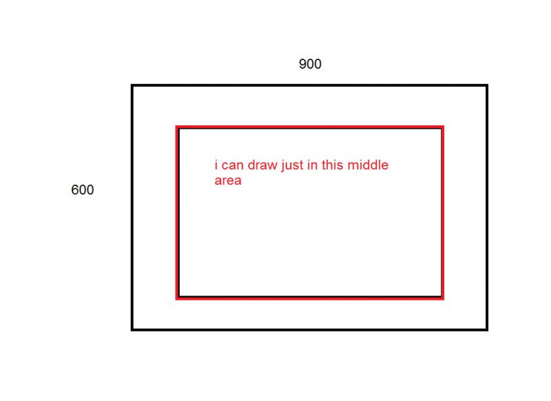

stefan1km Posted January 5, 2017 Posted January 5, 2017 Fine. In which case you must select the lower left-hand corner of the tablet overlay and the upper right-hand corner of the tablet overlay (should be a black donut-like circle at each of these locations) as your screen pointing area. What kind of drawing are you digitizing? Is it a site plan? Yes its landscape orientation of drawing and table, dimensions are 900x600 i calibrate all 4 points correctly but when i try to draw on surface of 900x600 like its marked on picture i cant draw in all size of 900x600 just on middle of limits size of 900x600 Quote

ReMark Posted January 5, 2017 Posted January 5, 2017 yes but my friend wants to use tablet for that, he set draw on table and then with polylines digitize drowing in AutoCad, just we cannot set some calibrations good I'd suggest a test run first. Take an A4 size piece of paper and lay it on the map. Now take a pencil and put a dot on the map just outside the lower left hand corner of the paper and the upper right hand corner of the paper. Remove the paper. Secure the map to the digitizer with tape making sure that the section of the map you are about to digitize falls within the limits of the digitizing area. Now calibrate the digitizer and when asked to pick the lower left hand corner click on the pencil dot. When prompted for the coordinates type 100,100. When next prompted to pick the upper right hand corner click on the pencil dot. When prompted for the coordinates type 310,397. For this to work the tablet must first be configured such that the entire limits is considered to be the drawing area. Configure first, then calibrate. It is a two step process. Now test by digitizing some of the features of the map into AutoCAD. Quote

ReMark Posted January 5, 2017 Posted January 5, 2017 If you don't want to do the test first that's fine with me. Configure the tablet for the largest possible digitizing area and then calibrate it using the coordinates 100,100 and 1000,700. Quote
stefan1km Posted January 6, 2017 Posted January 6, 2017 If you don't want to do the test first that's fine with me. Configure the tablet for the largest possible digitizing area and then calibrate it using the coordinates 100,100 and 1000,700. Okay friend i will try, thank you Quote
stefan1km Posted January 16, 2017 Posted January 16, 2017 Okay friend i will try, thank you i am success to make it work, it was only calibration problem as you said, thank you for support so much you are best! Quote
