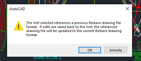

why this message? i don't understand?
So I guess if you look at the existing xref you selected you might find it is say, an AutoCAD 2018 format file and the new xref you are saving might be an AutoCAD 2024 format file. Files are backwards compatible generally (so 2024 will open a 2018 file) but not necessarily forward compatible (so 2018 might not open a 2024 file) - I think the warning is there in case others use the xref with older versions of AutoCAD.
You can check - I think this works - open the existing file and type 'version' in the command line to get its current version, and then compare that to the settings as SLW210 suggests
Ok thanks but is annoying this message. I have acad2023 and can open this files.i create this ext ref with lisp!
Edited by jim78b
if it is only you that uses the xref, or if everyone has the same version of CAD, I'd be tempted to open and save as a new revision
