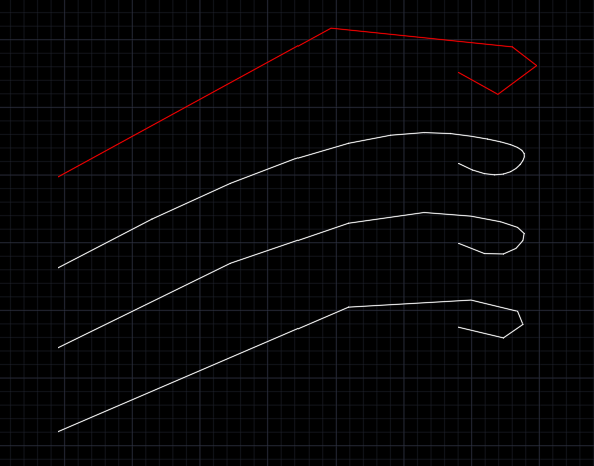

lrm Posted January 14 Share Posted January 14 A curve (spline) in AutoCAD is defined by a paramteric equation. This means to find a point on the curve you can specify a single parameter and in return you will get the location of a point on the curve. The range of the parameter will be from 0.0 to some upper limit the value of which can be foud as noted here. For example, (setq endSpline (vlax-curve-getEndParam splineObj)) Note that the geometric distance between points of equal parametric spacing are not equal if the curvature is not constant. A curve will have more chords where it has a tighter (smaller) radius. In the image below the red curve shows the location of control vertices for a spline. The three white curves show the evalution of the spline for different numbers of segments (changes in the parameter). Note that the chords that are used to approximate the smooth spline are shorter where the curvature is tighter. You ask "...how dose the function "know" that param is a vertex...". t's not clear what you consider a vertex. The most reasonable vertices to access when dealing with splines are the control vertices. Fit point vertices can become meaningless if the spline is edited. The following will create a list of CVs. (defun c:test (/ ent ed x nlist ) (setq ent (car (entsel "\nSelect spline")) ed (entget ent) ) (FOREACH x ed (IF (EQ 10 (CAR x)) (SETQ nlist (CONS (CDR x) nlist)) ) ) (princ nlist) (princ) ) Quote Link to comment Share on other sites More sharing options...
