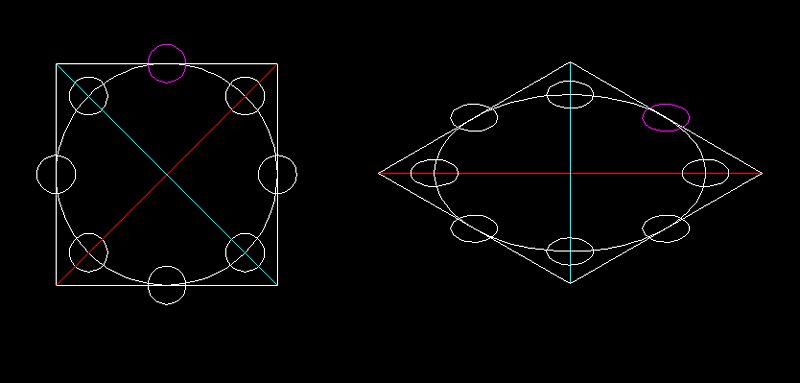

elmways Posted February 27, 2009 Author Posted February 27, 2009 Ps The tip works fin but now i need to know how to place a array of hole in a circle and make sure the first hole is at the angle i want from the horizontal or vertical center lines. Quote

rkent Posted February 27, 2009 Posted February 27, 2009 elmways said: Ps The tip works fin but now i need to know how to place a array of hole in a circle and make sure the first hole is at the angle i want from the horizontal or vertical center lines. You find non-iso locations by locating the x and y coordinates of the end points, or in this case the center points. Always start with an iso square (rectangle) bounding the work, transfer those dims to get an isometric drawing. There is a way to get an actual iso projection but the method above is more than good enough. Are the instructors actually showing folks how to do this stuff or are you just left to your own devices? I think this might be the case of someone teaching the software only rather than teaching drafting with software. And the fillet command works just fine, describe exactly how you are setting up the fillet command, length of lines, fillet radius, etc. Quote
elmways Posted March 14, 2009 Author Posted March 14, 2009 Thanks for that tip on how to place items in a ISO drawing it worked well. Ihave hopefully attached a drawing i have done using your suggestion. Not too bad for my first attempt. I think i can only get better. Back to revision first exam soon. Once again thanks. sample iso_1.dwgFetching info... Quote
