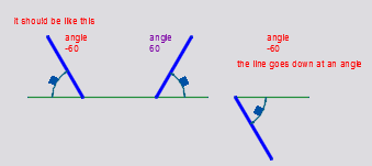

Is it possible to slightly change lisp "11" so that the line at an angle (minus) (anglevalue) does not go under the X axis?

2 hours ago, Nikon said:
Happy New Year to all
Prohibition of entering a negative value

4 minutes ago, Steven P said:
Yes, use 'abs' where you enter the angle. Will let you have a go to work it out

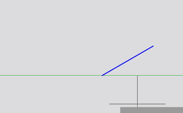

@1958 & @Steven PThank you and happy new year!
This last code draws a line at an angle (-60) to the right side,
if you set the angle (-30), then the dotted line shows the Angle (-60), and the line turns to the right side (30)...
Edited by Nikon
You enter the angle value - 30 degrees to the 0-X axis, and move the cursor to the floor at an angle of 120 degrees. Paradox! 😀
