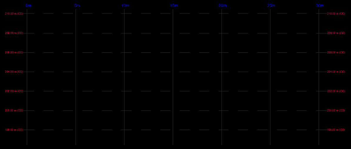

RBrigido Posted December 22, 2023 Share Posted December 22, 2023 Guys, I want to create a lisp routine that creates a GRID format, where the height between the horizontal lines is 2.00m and the vertical lines are 5m apart each. Below I put an image to use as a model to follow. Any idea? Quote Link to comment Share on other sites More sharing options...

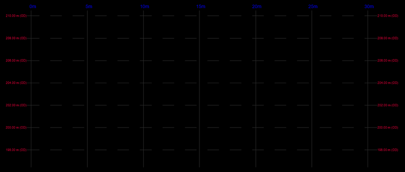

RBrigido Posted January 16 Author Share Posted January 16 Hi guys, Thanks for your contributions. This made me think in other ways and I ended up creating my own model. I am making it available below for anyone interested in using it. Many thanks, Rodrigo Brigido. RULER.lsp 2 Quote Link to comment Share on other sites More sharing options...
BIGAL Posted January 16 Share Posted January 16 (edited) Just me I would make all the layers in one go just run at start, using a (foreach lay lays, the lays list has the name color linetype etc for each layer. Then entmake. So your "create line" does not need to check for a layer every time a line is drawn. You can use (setvar 'clayer yourlayer) to set correct layer. Same with text style (if (= mystyle nil) (make the style)) where mystyle is the name of your style. This way its not ran every time you add a grid. Good to see having a go, you get more help if you try coding 1st. Edited January 16 by BIGAL Quote Link to comment Share on other sites More sharing options...
