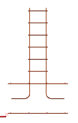

so do i dash it? or what am i supposed to do to it to make it correct?

The two cages would have to be separated. The "key" that P-F had you insert into the footing would only be there if the pier was poured after the footing. Otherwise, if it were one monolithic pour there would be no reason to form the key in the first place. Additionally, to be correct, P-F should have had some rebar in the shape of an "L" coming up from the footing into the pier above to tie the two sections together when the pier was poured. But I guess they neglected to mention this as they must figure they are only trying to teach you AutoCAD not structural engineering. That's how they can get away with being "sloppy" in their project instructions.
An example of steel reinforcement that might be used for a footing and a pier.
The two horizontal "mats" are comprised of #4 rebar 12" O.C. (on center) both ways.
The four vertical bars bent in the shape of a letter "L" are hooks used to tie the footing to the pier. The hooked ends keep the bars from pulling out.
The six square shapes with the rounded corners would be "bents". They tie the four hooks together and help to reinforce the pier.
The question for you is how would you draw the top, front and side views of this in 2D? Note the position of the rebars that comprise each mat. Four bars sit atop the three going left and right.
One of the views in 3D. Ignore the object and the 'X' in the lower left corner (part of the UCS icon).
