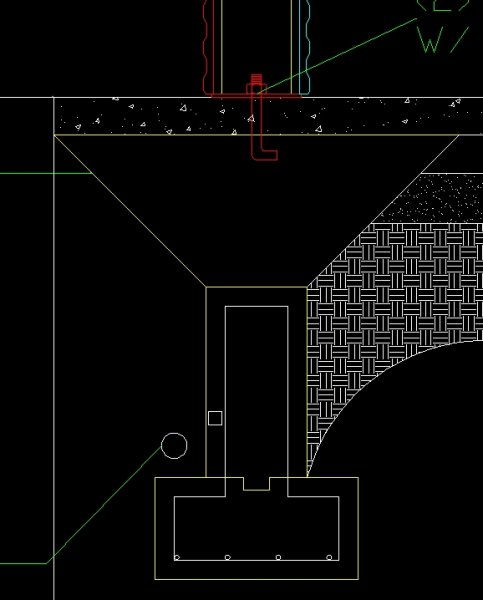

geussb Posted November 20, 2012 Posted November 20, 2012 i am confused as to how the rebar is supposed to look on plate 2 for structural drafting. and the fillet weld from the plate to the column. How are they supposed to look? ive tried to upload what i have so far and it keeps telling me its too large. but i would like some criticisms before i turn it in Quote

ReMark Posted November 20, 2012 Posted November 20, 2012 Post a screen shot of the detail you are working on. Do not post a DWG file. Why? Because some students come here looking to "borrow" other people's work if you know what I mean. You're having trouble detailing the footings and concrete piers? Quote
geussb Posted November 21, 2012 Posted November 21, 2012 Yes my footings don look like everyone's else's on other threads. I thought the rebar needs to go around the whole pier and footing 3" off. When I can get a screenshot to work I will post it to show Quote
ReMark Posted November 21, 2012 Posted November 21, 2012 As you can tell Penn-Foster assumes the student will know what to do exactly and judging from the various submissions I see they'll accept a wide range of interpretations. I imagine the rebar would form a cage of horizontal and vertical bars within both the footing and the pier. What does P-F provide as guidance given the project instructions are lacking in detail? Do they give you a secondary source of information to consult? Do they point you to a website? Do they provide a handout in addition to the PDF instructions? I'm curious. Quote
geussb Posted November 21, 2012 Posted November 21, 2012 they say to look in the structural drafting section booklet they sent and the picture they reference isnt even anything but a thick drawn L shape facing towards the left. but when they say that it should be 3" all around, i assumed it would be like you say, "a cage" and my screenshots wont post when i paste them into the space Quote
ReMark Posted November 21, 2012 Posted November 21, 2012 The footing and the pier won't necessarily be poured at the same time (thus the reason for the 'keyway'). Anyways, even if they were you would not have a continuous bar like the one you have shown. Quote
