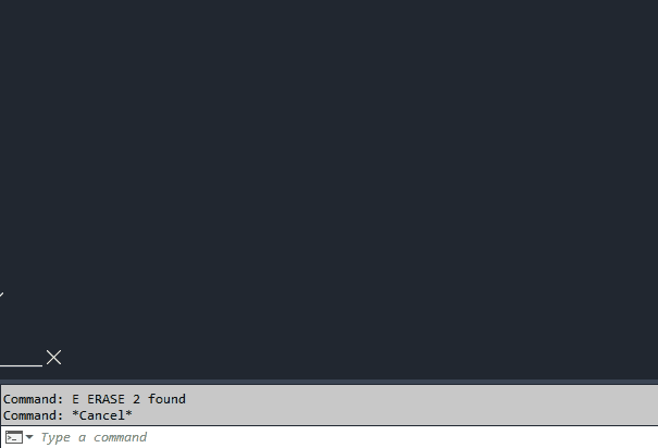

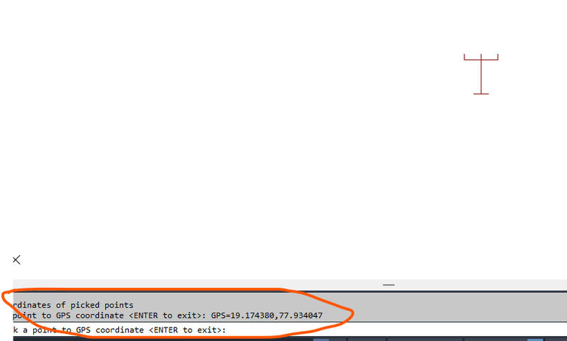

pmadhwal7 Posted December 21, 2023 Share Posted December 21, 2023 i found one on https://www.cadstudio.cz/freeware website lisp which Gives GPS coordinates of the place where i click but the lis only flash those coordinates and i want those in mtext aur proper format any one having idea i was also attached screenshot of those before and after lisp also attached. Lisp result:- Result What i Required format:- Geo2Gps.vlx Quote Link to comment Share on other sites More sharing options...

BIGAL Posted December 21, 2023 Share Posted December 21, 2023 So the result desired is a Latitude & Longitude, not X Y, there is various programs out there that will do that, the most important issue is that you have to set the world zone for where you are else the result will be pretty useless. Yes that is why this sort of thing is in CIV3D. 2 Quote Link to comment Share on other sites More sharing options...

BIGAL Posted December 23, 2023 Share Posted December 23, 2023 There is convert XY to Lat Long try finding that 1st. Again though must know a bit about where you are in the world with reference to world zones, certain values are used in the conversion formulas. Quote Link to comment Share on other sites More sharing options...
pmadhwal7 Posted December 23, 2023 Author Share Posted December 23, 2023 1 hour ago, BIGAL said: There is convert XY to Lat Long try finding that 1st. Again though must know a bit about where you are in the world with reference to world zones, certain values are used in the conversion formulas. firstly i was georeferenced my dwg file after that GPS coordinate reflect, Quote Link to comment Share on other sites More sharing options...
