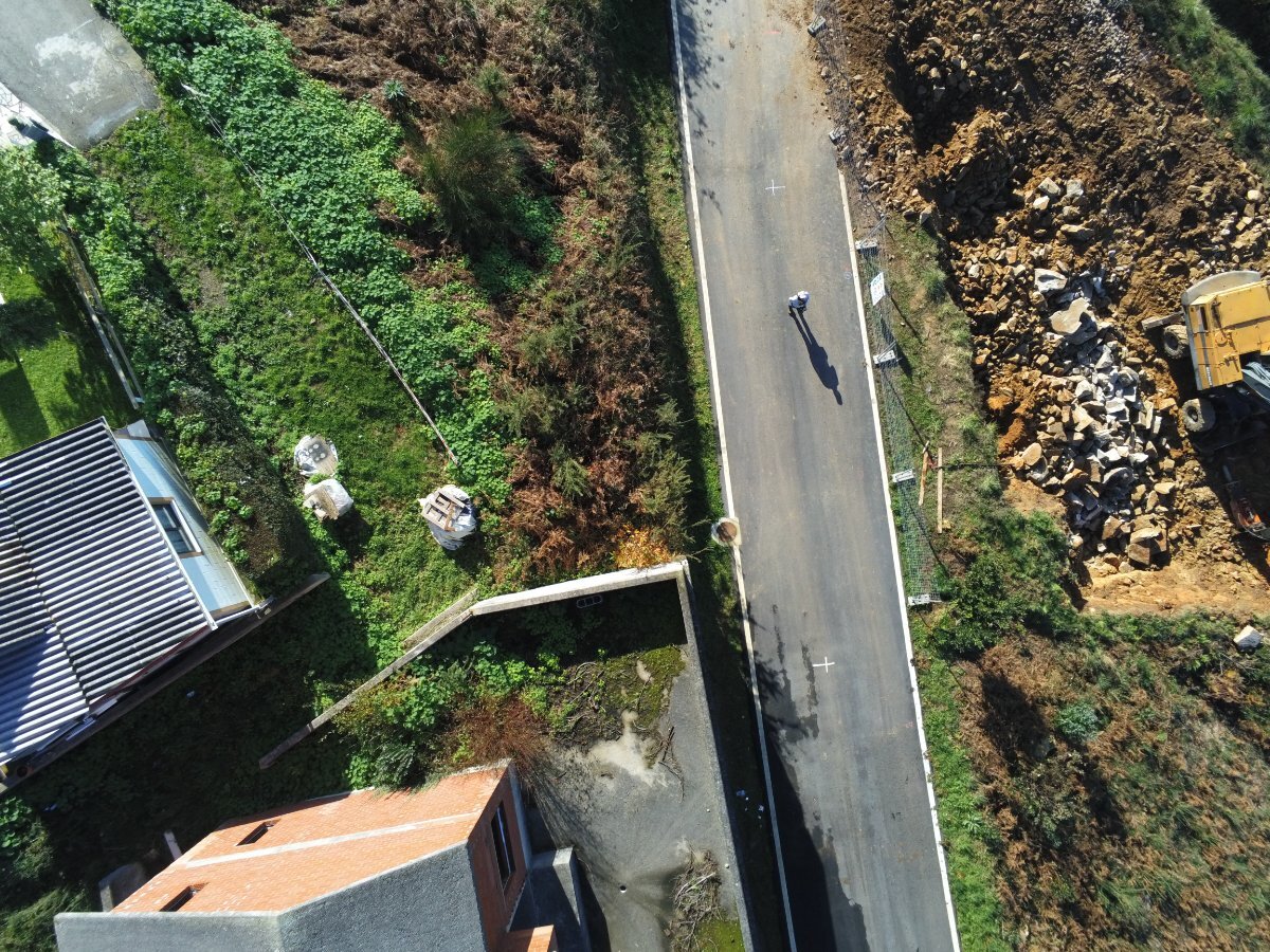

robierzo Posted December 17, 2023 Posted December 17, 2023 Hello. I wanted to know if it is possible to obtain the coordinates of a photograph by using Lisp. The photograph was taken with a drone. I attach an image capture, in which the properties appear, when I right-click on the photograph. Thank you so much. Quote
