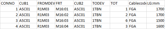

vinayak Posted December 13, 2023 Posted December 13, 2023 I want to draw a poly line (x,y- straight line) in auto cad by using below data its in xl. i have ATTE text block in autocad which name is (R1M03 & 1TBINT), my intention is to cross check the length of line (LG:mm), I need Lisp to draw a line by using this XL data in Autocad, please help Quote
Steven P Posted December 13, 2023 Posted December 13, 2023 Excel to AutoCAD lisps are out there to find. Looking at your data I can't identify a coordinate for the start and end points of the line Quote
BIGAL Posted December 13, 2023 Posted December 13, 2023 Post a dwg, like Steven no idea can see column "I" has something. Quote
vinayak Posted December 15, 2023 Author Posted December 15, 2023 On 12/13/2023 at 4:01 PM, vinayak said: I want to draw a poly line (x,y- straight line) in auto cad by using below data its in xl. i have ATTE text block in autocad which name is (R1M03 & 1TBINT), my intention is to cross check the length of line (LG:mm), I need Lisp to draw a line by using this XL data in Autocad, please help Sorry for late replay, i edited the name of 1tbn, sample enclosed, i want to automate the line to draw, presently manually drawing the line and measuring the length and adding extra length making it to round up and i have many different name points like 1TBN . please help if any lisp. Thanks in advance - vinayak test.dwg Quote

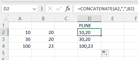

fuccaro Posted December 15, 2023 Posted December 15, 2023 With some basic Excel skills, you could get a row with the coords like this: X1,Y1 X2,Y2 .... Xn,Yn Copy that row in the clipboard and start AutoCAD. Turn off the OSNAP. In the command line type PLINE<enter> and when you are prompted for the points, paste the clipboard content in the command line, It should draw the polyline you are after... Quote

BIGAL Posted December 16, 2023 Posted December 16, 2023 Like fuccaro, put PLINE as 1st row, you can use a formula to work out the X & Y values then use Concatenate to make the X,Y in Excel. Quote
