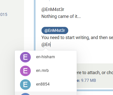

Nikon Posted December 14, 2023 Author Share Posted December 14, 2023 EnM4st3r, Please teach me how you create usernames. Quote Link to comment Share on other sites More sharing options...
EnM4st3r Posted December 14, 2023 Share Posted December 14, 2023 58 minutes ago, Nikon said: EnM4st3r, Please teach me how you create usernames. you just have to type @ and then the username after that. A selection will pup up automatically @Nikon Quote Link to comment Share on other sites More sharing options...
Nikon Posted December 14, 2023 Author Share Posted December 14, 2023 (edited) @EnM4st3r Nothing came of it... @EnM4st3r You need to start writing, and then select from the drop-down list Edited December 14, 2023 by Nikon 1 Quote Link to comment Share on other sites More sharing options...
