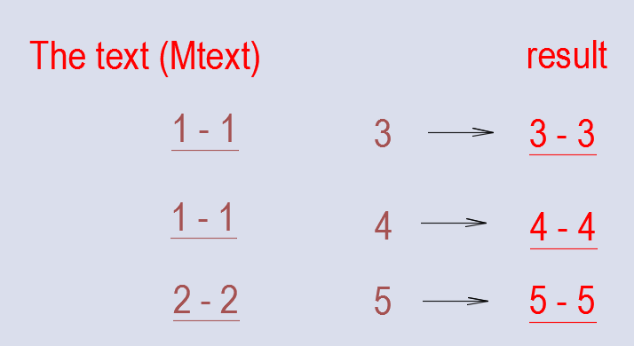

Is there a way to write code in lisp that can replace text like: 1-1 with
2-2, etc. in one digit.
I.e. I call the command, select the text 1-1, enter the number 3, for example, and get 3-3.
If the text and mtext are underlined, then good.

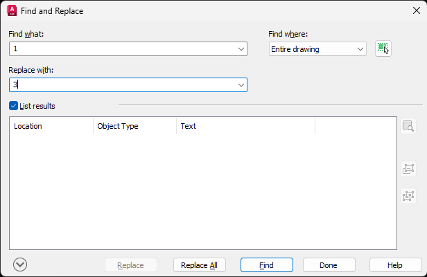

Just to check you wanting to select each text in turn rather than all of them globally - such as 'Find' would do?

You just need to replace the text "1-1" (number - number) with "2-2", for example, but enter only one number 2.
Unfortunately, I am not a programmer...

1 hour ago, ronjonp said:
My first thought too, but I'm guessing the OP has reasons not to use Find (perhaps a drawing with 100 suitable texts, wants to change just one, for example)

If you add an underscore "%%u" to the fuccaro lisp, so that the text remains underlined...
The underlined text in the properties looks like this:
%%u1-1
How to add this to lisp correctly?

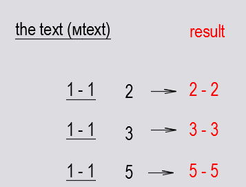

EnM4st3r, thank.  How to add this to lisp correctly?
(strcat  "%%u" nr " - " nr)
(strcat  "{\\L" nr " - " nr  "}")
If so:
(defun c:pp2()
  (setq el (entget (car (entsel "pick (m)text")))
	nr (itoa (getint "enter number"))
	el (entmod (subst (cons 1 (strcat  "{\\L" nr " - " nr  "}") (assoc 1 el) el)))

(defun c:pp()
	el (entmod (subst (cons 1 (strcat  "{\\L" nr " - " nr  "}")) (assoc 1 el) el)))
Edited by EnM4st3r
EnM4st3r, thank.  it works with mtext
if you select underlined text  -   {\L6 - 6} ???
how can this be fixed?
Edited by Nikon
this should work for both
(defun c:pp(/ el nr str)
  (cond
    ((wcmatch (cdr (assoc 0 el)) "MTEXT")
     (setq str (strcat  "{\\L" nr " - " nr  "}"))
    ((wcmatch (cdr (assoc 0 el)) "TEXT")
     (setq str (strcat  "%%u" nr " - " nr))
    (t
      (alert "thats no text obj")
      (exit)
	(entmod (subst (cons 1 str) (assoc 1 el) el))
