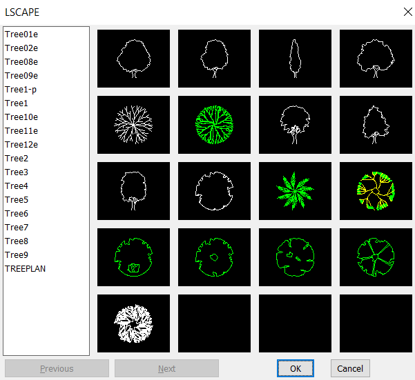

BIGAL Posted December 9, 2023 Posted December 9, 2023 The trees are blocks that have been made over time. They are a choice in a POP menu, I would look at below image draw a circle then just turn snap off and zig zag a pline around the circle the big hint is make the circle 1 unit in diameter. Or just do a few circles. Quote
