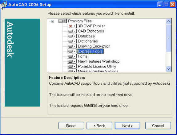

Cad64 Posted March 8, 2009 Posted March 8, 2009 Try the Express Tools "Command Alias Editor". Just go to the 'Express' pull down menu > Tools > Command Alias Editor, or type ALIASEDIT at the command line. This is assuming that you included the Express Tools when you installed Autocad? Quote
Butch Posted March 8, 2009 Author Posted March 8, 2009 Didnt installed it :-( Any step by step tutorial maybe or could someone guide me? Quote
Cad64 Posted March 8, 2009 Posted March 8, 2009 The Express Tools are on your installation CD. Just insert the disk, select "Custom" installation and load them. Quote
Cad64 Posted March 8, 2009 Posted March 8, 2009 You can also add or change command aliases by opening your acad.pgp file and editing it manually. Go to your 'Tools' pull down menu > Customize > Edit Program Parameters (acad.pgp). This will open your pgp file in Notepad so you can edit it as necessary. Once the file is open, scroll all the way down to the bottom of the file, to the User Defined Command Aliases. This is where you add new aliases or create overrides for existing ones. Make sure you type them in the proper format. Look at the existing ones to see how they are written. When you're finished, save and close the file. Then back in Autocad, type REINIT to open the Re-initialization dialog. Select "PGP File" and hit Ok. Now your changes will take effect. Quote
