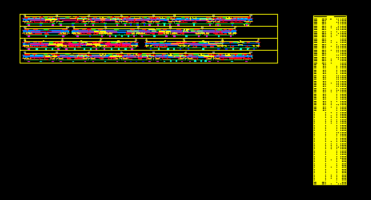

A Tabasi Posted January 1, 2024 Author Posted January 1, 2024 (edited) Happy New Year I Wish best happens in the new year for you I checked this lisp, that's great. Although it's improved over the first version, there are still a few issues. For example; 1- Different numbers are assigned for similar rebars. a part of this problem is related to visibility states rebar block. actually "L1 shape" and "L shape" both of them have similar shapes. As a result, we should find a solution for this. 2- Also I saw that "Smooth Shape" Rebars have different marks for similar rebars. I don't understand why this problem has been created. 3-sometimes maybe should we need to mark the Rebars of the beam to the beam. so It will be better When LISP is loaded, before creating the final table, the user selects specific rebars and tags for the assignment mark, and then the final table is created by LISP. Finally, I would like to express my gratitude for your cooperation and help in this process. Edited January 1, 2024 by A Tabasi Quote
BIGAL Posted January 1, 2024 Posted January 1, 2024 "1- Different numbers are assigned for similar rebars" ? Each bar is sorted based on bar type, length and bundle number of bars, this is reflected in the count column. You need to supply an example table say for the top beam in your sample dwg. 2- Also I saw that "Smooth Shape" Rebars have different marks for similar rebars, The bars have different groups like a L=5.00M can have 3T10 or 3T20. 3 Can look into adding beam ID. Quote

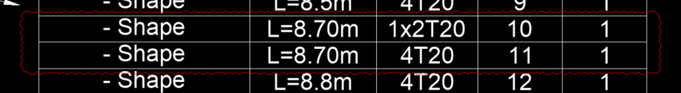

A Tabasi Posted January 2, 2024 Author Posted January 2, 2024 1- I mean some Rebars by the Same Identity have different marks. Please look at the file attached in the table that has Revcloud. 2-although the bars have different groups, in same groups have different marks. for example; L=5.00m 5T20 , mark is 34 while L=5.00m 6T20, mark is 35 ! Both of them are Smooth Shapes. it's not correct. 3- I don't understand what you mean. I want in the file that has many beams, I do numbering bars beam to beam Test Lisp -new version.dwgFetching info... Quote
BIGAL Posted January 2, 2024 Posted January 2, 2024 Ok I think I understand, say the - Shape L=8.7m becomes say 10 with count 2, please confirm. 1 Quote
BIGAL Posted January 8, 2024 Posted January 8, 2024 (edited) You did not confirm see post above only want to do once. Match common name and length and get total count. Ignore 2xT20 2xT16 etc Edited January 8, 2024 by BIGAL Quote

BIGAL Posted February 5, 2024 Posted February 5, 2024 Please try this and check carefully that it is correct. Run on a small number of reo bars, increase during checking. Note in sample dwg there are problems like L8.05m which should be L=8.05, I think I fixed like 5. ReoBarcount2.lspFetching info... Quote
A Tabasi Posted February 11, 2024 Author Posted February 11, 2024 (edited) it's wonderful, thanks a lot man. you do big help me. Now I'm so happy and I appreciate your kindness. so, for the last question, how do select a specific beam in the drawing for the numbering bar? For example; I want to select a couple of beams from all the beams in my drawing so that naming is done only for them. Edited February 11, 2024 by A Tabasi Quote
