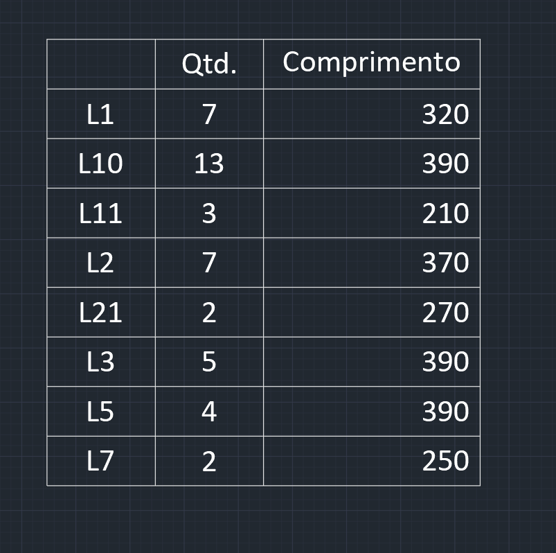

Sort table whith block attributes
henrique
I have a list with block attributes "L1 320 12" "L2 270 5" "L3 320 12" ..... "L10 320 12" "L11 330 12" .... "L20 400 18"
I need to sort by the first item:
"L1 320 12" "L10 320 12" "L11 330 12"  "L2 270 5" "L20 400 18" "L3 320 12"
but I need
"L1 320 12" "L2 270 5" "L3 320 12".... "L10 320 12" "L11 330 12"..... "L20 400 18"

You need to use VL-sort and sort the list of values to go into the table before putting those values into cells. I redid the list as individual items then it sorts on the alpha characters.
(setq lst (list '("L1" 320 12) '("L10" 320 12) '("L11" 330 12) '("L2" 270 5) '("L20" 400 18) '("L3" 320 12)))
; By pbejse forums/autodesk
(defun _n (str / s)
(setq s (vl-string-right-trim "0123456789" str))
(list s (atoi (substr str (1+ (strlen s)))))
(Defun ThisFunc (l)
(Vl-sort l'(lambda (n m)
		(setq n (_n (Car n)) m (_n (Car m)))
			(cond
			  ((< (Car n) (car m)))
			  ((eq (Car n) (car m)) (< (Cadr n) (cadr m)))
(setq lst thisfunc lst)
(ThisFunc  lst)
(("L1" 320 12) ("L2" 270 5) ("L3" 320 12) ("L10" 320 12) ("L11" 330 12) ("L20" 400 18))
