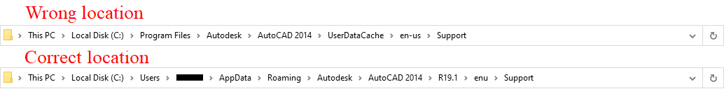

basty Posted November 25, 2023 Author Share Posted November 25, 2023 (edited) Do you mean I'm not allowed to overwrite the acad.lin file? How about make a copy of it and edit it using Notepad then rename the file and load it in my AutoCAD 2014? I have a backup file before I edit the original acad.lin using Notepad. Edited November 25, 2023 by basty Quote Link to comment Share on other sites More sharing options...
basty Posted November 25, 2023 Author Share Posted November 25, 2023 OK, now it works. Thanks. The reason of why it doesn't works is because I edit the acad.lin in the wrong location. Quote Link to comment Share on other sites More sharing options...
eldon Posted November 25, 2023 Share Posted November 25, 2023 Well done for tracking down the file that is in use. My point about overwriting the linetype is that the lines in this file are universal to AutoCAD. By altering the linetype definition for your computer, if anyone else opens your drawing on another machine, then your linetype would not show as you intend it to. For universal use, it is proper, when writing a new linetype definition, to name the linetype something unique, like Equal-dash then every else will see your linetype instead of seeing the default one. It is only a matter of copying a couple of lines, inserting them and then altering them as required. Quote Link to comment Share on other sites More sharing options...
