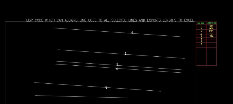

Hi Forum..!
I am looking for a LISP that would assign a identity code to all selected lines and also mention the lines length in adjacent cell and can be exported to excel.
Please Help..

1. Getlengt h By Sir Tharwat - The selection of all lines is what i need like in this code - but I need individual line lengths and it would be great if each line is assigned with a identity Code text on the line itself
2. PkLength Author Unkown - this code works good with Indvidual lines but one has to select one line at a time.

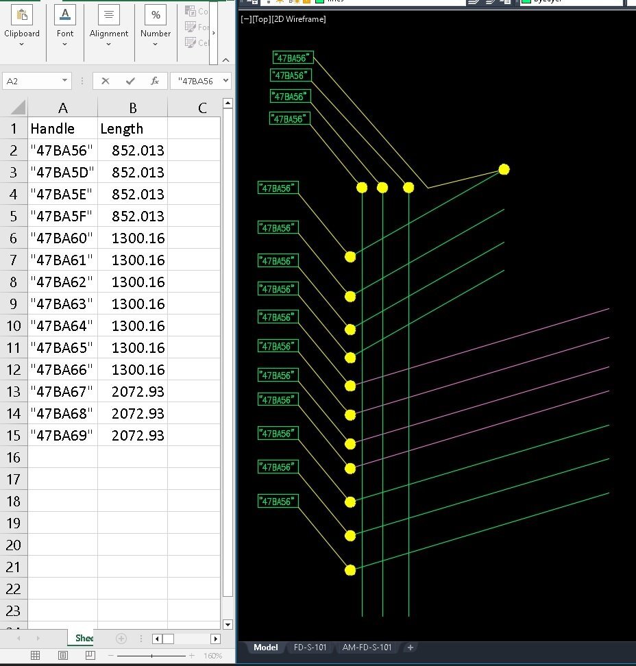

Maybe i am asking too much,.. can this feature be added where in leaders to Indvidual lines with the Handle mentioned appears in the drawing automagicaly ?
@CADSURAY
Quote
This?

Million Thanks to you Tsuky.!
Exactly Spot on...! 🙌

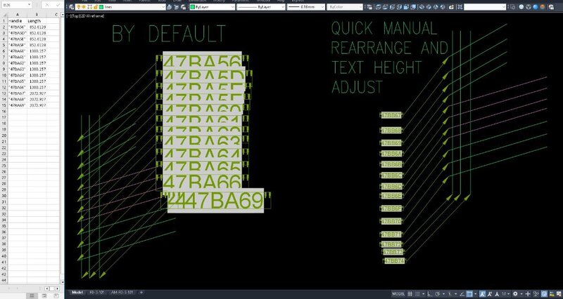

Had to do a few seconds of tweaking and rearranging.
Thats completely fine, as the case may be one has to do it is the best way suitable to the drawing, this lisp is just great.!
