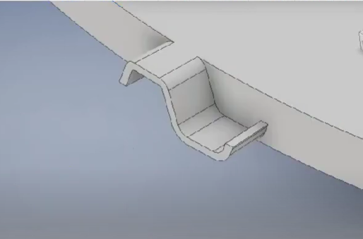

basty Posted November 22, 2023 Posted November 22, 2023 Could someone tell me please how do I create an oil ring in AutoCAD like image below? Thank you Quote

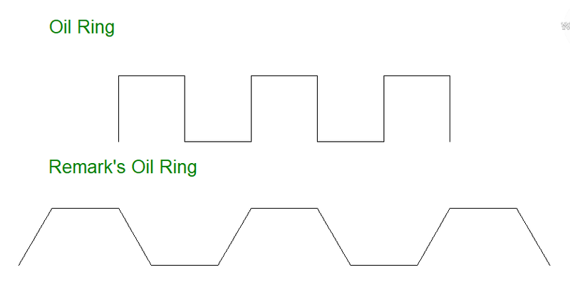

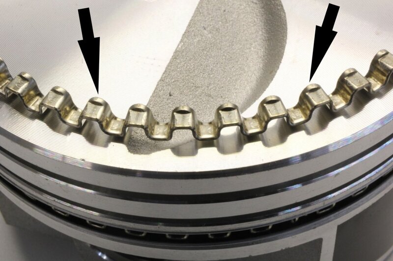

ReMark Posted November 23, 2023 Posted November 23, 2023 Actually, the part that you show is called a spacer. An oil ring consists of a spacer sandwiched between the upper and lower rails which would be flat. I would suggest you create something along these lines... Quote
basty Posted November 23, 2023 Author Posted November 23, 2023 On 11/23/2023 at 11:45 AM, ReMark said: Actually, the part that you show is called a spacer. An oil ring consists of a spacer sandwiched between the upper and lower rails which would be flat. I would suggest you create something along these lines... Expand I don't understand. Please show the breakdown of the steps. Quote
ReMark Posted November 23, 2023 Posted November 23, 2023 You create the profile and extrude it. Quote
ReMark Posted November 23, 2023 Posted November 23, 2023 (edited) Just the way you would create a profile for any other shape you want to extrude. Assuming you have all the proper dimensions, I would create the profile in 2D. Next, I would switch to an isometric view. Rotate the profile so the spacer is standing vertically. Extrude the profile at least twice the required width. Draw two concentric circles representing the inner and outer radius of the spacer based off the centerline of your extruded profile. Extrude each circle a height that is greater than that of your profile then use the extruded circles to slice the extruded profile. The result should be somewhat similar to what I pictured. Then create an array of that extruded profile. This is all off the top of my head as I am not in a position to access my CAD computer. Edited November 23, 2023 by ReMark Quote
BIGAL Posted November 23, 2023 Posted November 23, 2023 (edited) Like remark and following on from your other post about making a gear, its radial you need to use a loft to take into account the inner and outer radius will be different, even though we are talking like 0.05 differance. The bottom/top flats need to include that subtle angle. OK why are you doing it, Is it a school project ? After all its way beyond a engineering shop to make. Go to local car parts supply and buy. Edited November 23, 2023 by BIGAL Quote
basty Posted November 24, 2023 Author Posted November 24, 2023 On 11/23/2023 at 6:51 PM, ReMark said: Just the way you would create a profile for any other shape you want to extrude. Assuming you have all the proper dimensions, I would create the profile in 2D. Next, I would switch to an isometric view. Rotate the profile so the spacer is standing vertically. Extrude the profile at least twice the required width. Draw two concentric circles representing the inner and outer radius of the spacer based off the centerline of your extruded profile. Extrude each circle a height that is greater than that of your profile then use the extruded circles to slice the extruded profile. The result should be somewhat similar to what I pictured. Then create an array of that extruded profile. This is all off the top of my head as I am not in a position to access my CAD computer. Expand How to do it? I don't understand. It's easy if the line is straight. Your example are, the profile, is sloped line. And what makes difficult to me is, it's a radial. Quote
basty Posted November 28, 2023 Author Posted November 28, 2023 (edited) On 11/23/2023 at 11:45 AM, ReMark said: Actually, the part that you show is called a spacer. An oil ring consists of a spacer sandwiched between the upper and lower rails which would be flat. I would suggest you create something along these lines... Expand This is what my question mean: How do I create an oil ring like ReMark in 3D? Edited November 28, 2023 by basty Quote
