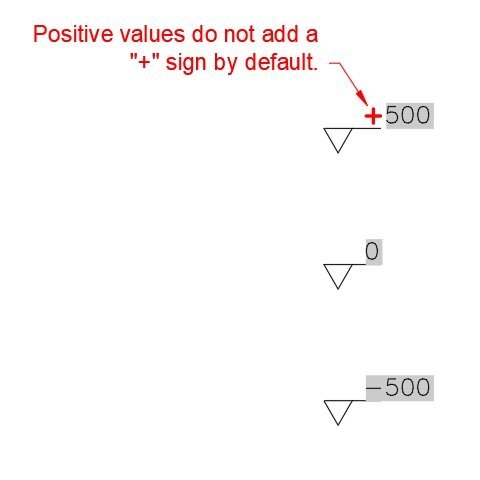

I have created a block attribute to display generic levels (Y-coordinates) however I'm unable to display a "+" sign next to the positive values. Negative values are displaying correctly.
I can add a prefix to all positive values but that would be a manual workaround to this problem. Let me know if you have any other "automatic" solution.
Thanks!
Someone found a solution here, which involves a dynamic lookup table, so it dynamically goes over my head. Apparently there's nothing as simple as turning off a suppress toggle.
If you use a lisp when picking insert point + or -ve then you can insert block and fill in the attribute with + or -. Or need to have a play an attribute as a field using Y value of insert.
