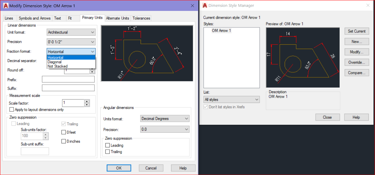

I use Autocad for Mac, but the solution may be the same as for a PC.  Recently the ability to type stacked diagonal dimension text went away. Previously it would default to stacked diagonal without any special characters. Now it looks like 3/4 or stacked straight up and down if I use the text editor. How do I reset for automatic stacked diagonal dimensions.

In Autocad for PC you would fix that by going into the DIMSTYLE MANAGER.

As in the screenshot, you MAY find the relevant options presented on the Primary Units tab.
Should you find this has some relevance to the Autocad for Mac options available,
make sure to click OK after making your changes.
I hope that helps you.

screenshot added
