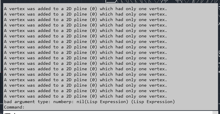

teddy_boi Posted November 11, 2023 Posted November 11, 2023 (edited) I tried using the Flatten Command but it is showing bad argument type error: numberp: nil(Lisp Expression) How do I resolve this? Command: FLATTEN Initializing... Select objects to convert to 2d... Select objects: Specify opposite corner: 2909 found Select objects: Remove hidden lines? <No>: A vertex was added to a 2D pline (0) which had only one vertex. A vertex was added to a 2D pline (0) which had only one vertex. A vertex was added to a 2D pline (0) which had only one vertex. A vertex was added to a 2D pline (0) which had only one vertex. A vertex was added to a 2D pline (0) which had only one vertex. A vertex was added to a 2D pline (0) which had only one vertex. A vertex was added to a 2D pline (0) which had only one vertex. A vertex was added to a 2D pline (0) which had only one vertex. A vertex was added to a 2D pline (0) which had only one vertex. A vertex was added to a 2D pline (0) which had only one vertex. A vertex was added to a 2D pline (0) which had only one vertex. A vertex was added to a 2D pline (0) which had only one vertex. A vertex was added to a 2D pline (0) which had only one vertex. A vertex was added to a 2D pline (0) which had only one vertex. A vertex was added to a 2D pline (0) which had only one vertex. A vertex was added to a 2D pline (0) which had only one vertex. A vertex was added to a 2D pline (0) which had only one vertex. A vertex was added to a 2D pline (0) which had only one vertex. A vertex was added to a 2D pline (0) which had only one vertex. A vertex was added to a 2D pline (0) which had only one vertex. A vertex was added to a 2D pline (0) which had only one vertex. A vertex was added to a 2D pline (0) which had only one vertex. A vertex was added to a 2D pline (0) which had only one vertex. A vertex was added to a 2D pline (0) which had only one vertex. A vertex was added to a 2D pline (0) which had only one vertex. A vertex was added to a 2D pline (0) which had only one vertex. A vertex was added to a 2D pline (0) which had only one vertex. A vertex was added to a 2D pline (0) which had only one vertex. A vertex was added to a 2D pline (0) which had only one vertex. A vertex was added to a 2D pline (0) which had only one vertex. A vertex was added to a 2D pline (0) which had only one vertex. A vertex was added to a 2D pline (0) which had only one vertex. A vertex was added to a 2D pline (0) which had only one vertex. A vertex was added to a 2D pline (0) which had only one vertex. A vertex was added to a 2D pline (0) which had only one vertex. A vertex was added to a 2D pline (0) which had only one vertex. A vertex was added to a 2D pline (0) which had only one vertex. A vertex was added to a 2D pline (0) which had only one vertex. A vertex was added to a 2D pline (0) which had only one vertex. A vertex was added to a 2D pline (0) which had only one vertex. A vertex was added to a 2D pline (0) which had only one vertex. A vertex was added to a 2D pline (0) which had only one vertex. A vertex was added to a 2D pline (0) which had only one vertex. A vertex was added to a 2D pline (0) which had only one vertex. A vertex was added to a 2D pline (0) which had only one vertex. A vertex was added to a 2D pline (0) which had only one vertex. A vertex was added to a 2D pline (0) which had only one vertex. A vertex was added to a 2D pline (0) which had only one vertex. A vertex was added to a 2D pline (0) which had only one vertex. A vertex was added to a 2D pline (0) which had only one vertex. A vertex was added to a 2D pline (0) which had only one vertex. A vertex was added to a 2D pline (0) which had only one vertex. A vertex was added to a 2D pline (0) which had only one vertex. A vertex was added to a 2D pline (0) which had only one vertex. A vertex was added to a 2D pline (0) which had only one vertex. A vertex was added to a 2D pline (0) which had only one vertex. A vertex was added to a 2D pline (0) which had only one vertex. A vertex was added to a 2D pline (0) which had only one vertex. A vertex was added to a 2D pline (0) which had only one vertex. A vertex was added to a 2D pline (0) which had only one vertex. A vertex was added to a 2D pline (0) which had only one vertex. A vertex was added to a 2D pline (0) which had only one vertex. A vertex was added to a 2D pline (0) which had only one vertex. A vertex was added to a 2D pline (0) which had only one vertex. A vertex was added to a 2D pline (0) which had only one vertex. A vertex was added to a 2D pline (0) which had only one vertex. A vertex was added to a 2D pline (0) which had only one vertex. A vertex was added to a 2D pline (0) which had only one vertex. A vertex was added to a 2D pline (0) which had only one vertex. A vertex was added to a 2D pline (0) which had only one vertex. A vertex was added to a 2D pline (0) which had only one vertex. A vertex was added to a 2D pline (0) which had only one vertex. A vertex was added to a 2D pline (0) which had only one vertex. A vertex was added to a 2D pline (0) which had only one vertex. A vertex was added to a 2D pline (0) which had only one vertex. A vertex was added to a 2D pline (0) which had only one vertex. A vertex was added to a 2D pline (0) which had only one vertex. A vertex was added to a 2D pline (0) which had only one vertex. A vertex was added to a 2D pline (0) which had only one vertex. A vertex was added to a 2D pline (0) which had only one vertex. A vertex was added to a 2D pline (0) which had only one vertex. A vertex was added to a 2D pline (0) which had only one vertex. A vertex was added to a 2D pline (0) which had only one vertex. A vertex was added to a 2D pline (0) which had only one vertex. A vertex was added to a 2D pline (0) which had only one vertex. A vertex was added to a 2D pline (0) which had only one vertex. A vertex was added to a 2D pline (0) which had only one vertex. A vertex was added to a 2D pline (0) which had only one vertex. A vertex was added to a 2D pline (0) which had only one vertex. A vertex was added to a 2D pline (0) which had only one vertex. A vertex was added to a 2D pline (0) which had only one vertex. A vertex was added to a 2D pline (0) which had only one vertex. A vertex was added to a 2D pline (0) which had only one vertex. A vertex was added to a 2D pline (0) which had only one vertex. A vertex was added to a 2D pline (0) which had only one vertex. A vertex was added to a 2D pline (0) which had only one vertex. A vertex was added to a 2D pline (0) which had only one vertex. A vertex was added to a 2D pline (0) which had only one vertex. A vertex was added to a 2D pline (0) which had only one vertex. A vertex was added to a 2D pline (0) which had only one vertex. A vertex was added to a 2D pline (0) which had only one vertex. A vertex was added to a 2D pline (0) which had only one vertex. A vertex was added to a 2D pline (0) which had only one vertex. A vertex was added to a 2D pline (0) which had only one vertex. A vertex was added to a 2D pline (0) which had only one vertex. A vertex was added to a 2D pline (0) which had only one vertex. A vertex was added to a 2D pline (0) which had only one vertex. bad argument type: numberp: nil(Lisp Expression) (Lisp Expression) Edited November 11, 2023 by teddy_boi Quote

teddy_boi Posted November 11, 2023 Author Posted November 11, 2023 Hey, FLATSHOT is giving the error: "There are no solids or surfaces that can be projected." I'm uploading an image of the 3D model that i wanted to use FLATTEN on. I needed the plans and elevations of this model. Quote
Cad64 Posted November 11, 2023 Posted November 11, 2023 Well, the only other thing I could suggest would be to make a copy of the model and then explode everything. Then try running the Flatten command on the exploded model. Quote
