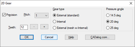

basty Posted November 13, 2023 Author Share Posted November 13, 2023 (edited) This is the menu of the 2DGear.lsp in my AutoCAD (see attached image please). What should I do in order to create the helical of my gear? What is pitch and how do I measure the pitch of my helical gear? What should I choose in the Gear Type section? How do I enter the value of the diameter of my helical gear to 58.3 mm? Edited November 13, 2023 by basty Quote Link to comment Share on other sites More sharing options...

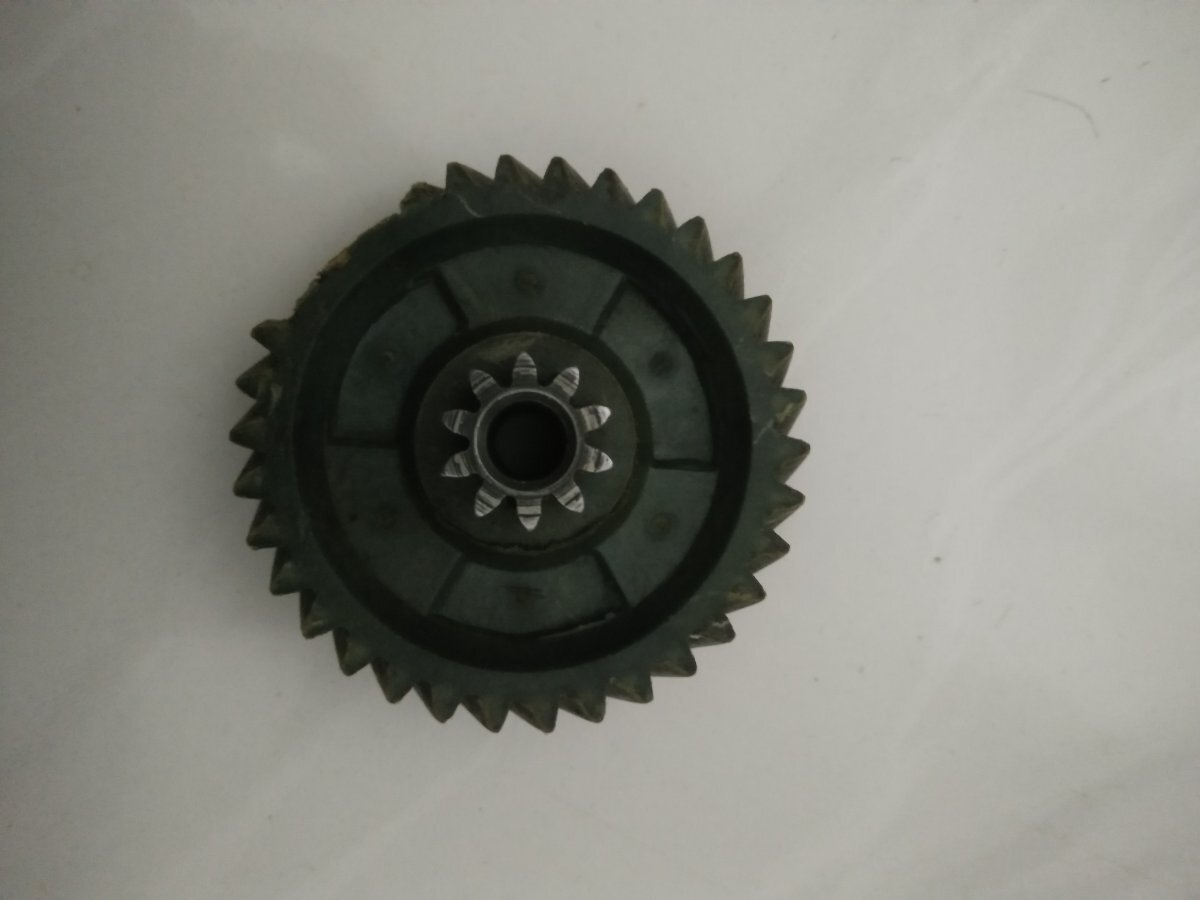

basty Posted November 13, 2023 Author Share Posted November 13, 2023 1 hour ago, lrm said: @basty Zooming in on the gear image you posted it is difficult to delineate the tooth profile from the 3rd dimension of the tooth. In the image below I have roughly shown what I think is the tooth profile in yellow and its depth in red. If you add some side lighting to the gear before taking the picture you may be able to see the involute more clearly. This is the bigger picture of my gear. Quote Link to comment Share on other sites More sharing options...

basty Posted November 13, 2023 Author Share Posted November 13, 2023 (edited) Please see this bigger picture. https://i.ibb.co/74rqv8s/Plastic-Gear.jpg Edited November 13, 2023 by basty Quote Link to comment Share on other sites More sharing options...
lrm Posted November 13, 2023 Share Posted November 13, 2023 Do these teeth mesh with another gear or are they used to come in contact with something else to do the paper shredding? Quote Link to comment Share on other sites More sharing options...

lrm Posted November 17, 2023 Share Posted November 17, 2023 @basty Sorry for the delay in responding. In a gear train one gear pushes against another. Since mating gears are usualy of differet diameters the result is a reduction, or and increase, of the rotational velocity from one gear to the next. Gear teeth usually have an involute profile (also known as a catenary curve). This shape is the most efficient for transferring the forces between gear teeth that "mesh" (come together). In thinking about a paper shredder it is unlikely that the teeth that do the shredding are involutes as they may not be meshing with another gear but may be used against a fixed plate as in the illustration below. or the damaged piece that you have is ysed in an offset specially design arrangement like the following. Quote Link to comment Share on other sites More sharing options...

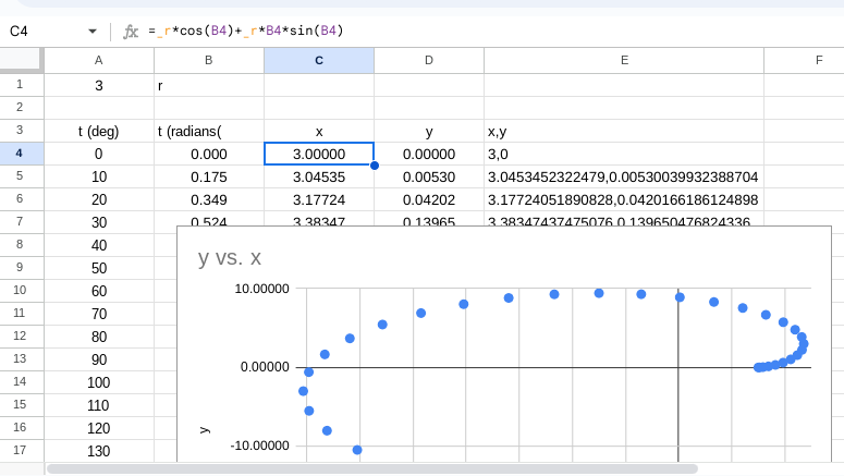

basty Posted November 23, 2023 Author Share Posted November 23, 2023 How do I create the involute curve in AutoCAD using equation like below attached image? Quote Link to comment Share on other sites More sharing options...
BIGAL Posted November 23, 2023 Share Posted November 23, 2023 Just convert formula to lisp syntax, use more than 1 line to make it easier to generate. (* (cos t) r) you can do the rest. (setq pt (list x y)) Quote Link to comment Share on other sites More sharing options...
lrm Posted November 24, 2023 Share Posted November 24, 2023 @basty if it's easier, just create a bunch of points in a spreadsheet and copy and past the x,y column data (column E in the example below) into AutoCAD after typing pline. As I mentioned earlier, I do not think the teeth you need to reproduce are involutes as I think the function is to shred paper and not to come in contact with another gear. Quote Link to comment Share on other sites More sharing options...
