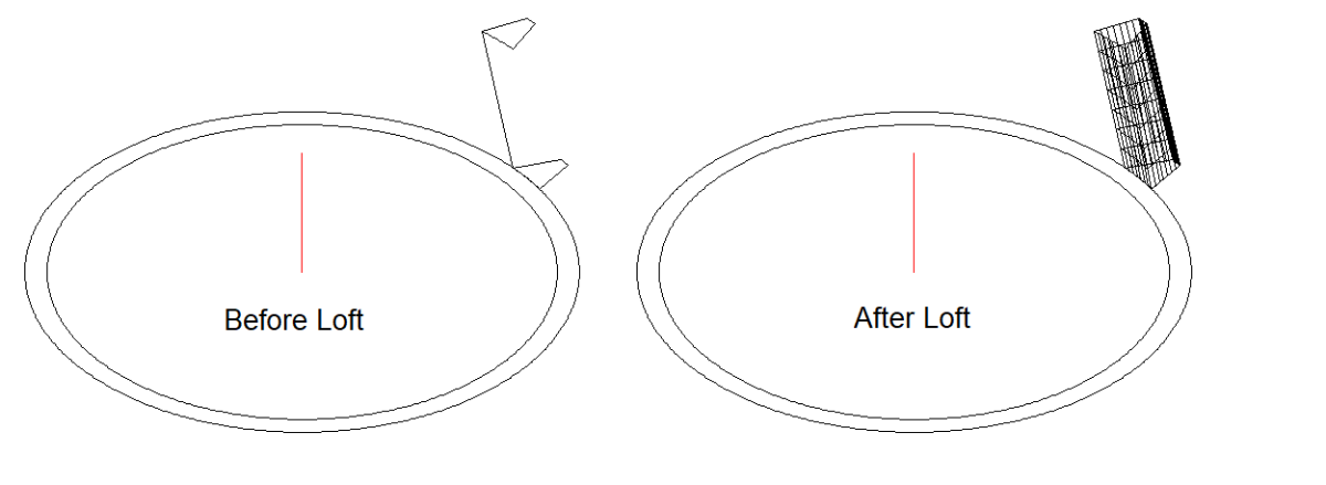

basty Posted November 10, 2023 Share Posted November 10, 2023 Can someone tell me please how do I make a helix gear in AutoCAD 2014 in classic workspace? Is it using Loft command or Sweep command? How do I use Loft command using a path? Quote Link to comment Share on other sites More sharing options...
basty Posted November 10, 2023 Author Share Posted November 10, 2023 Please see the attached .dwg file. The red line is the path. Gear.dwg Quote Link to comment Share on other sites More sharing options...
ReMark Posted November 10, 2023 Share Posted November 10, 2023 You can loft the two profiles to achieve the desired result. You don't need a path to do it either. Quote Link to comment Share on other sites More sharing options...

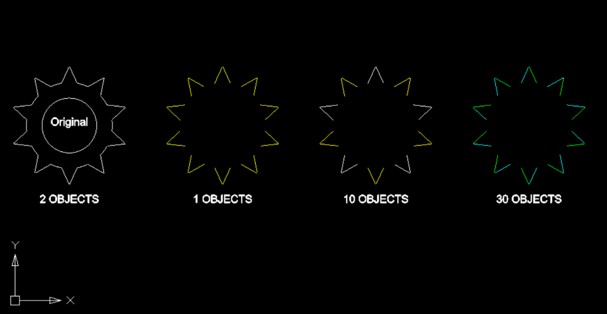

basty Posted November 11, 2023 Author Share Posted November 11, 2023 (edited) I use Explode command as you instructed and next, I make a Region of it. But I doesn't want to be extruded. The command message is: "Cannot sweep or extrude an object of this type." Edited November 11, 2023 by basty Quote Link to comment Share on other sites More sharing options...
ReMark Posted November 11, 2023 Share Posted November 11, 2023 You're going to have to explode the triangles a second time because, for some unknown reason, you created individual triangles as a block then grouped them together to create a second block. Your understanding of creating blocks needs some refinement. Quote Link to comment Share on other sites More sharing options...

basty Posted November 11, 2023 Author Share Posted November 11, 2023 (edited) 12 minutes ago, ReMark said: You're going to have to explode the triangles a second time because, for some unknown reason, you created individual triangles as a block then grouped them together to create a second block. Your understanding of creating blocks needs some refinement. Sorry, I followed your instruction but still doesn't works However, I manage to make it work. The step is, I make Region of the gear teeth (this case is triangle), then Extrude it, and next it to Polar Array 10 items. Edited November 11, 2023 by basty Quote Link to comment Share on other sites More sharing options...
basty Posted November 11, 2023 Author Share Posted November 11, 2023 1 minute ago, ReMark said: The image below demonstrates what lies at the root of your problem. On the far left is your original objects. I copied the triangles to the right. They represent one object. I copied the triangles to the right, again, and exploded them. Now you have ten objects. I copied them to the right, one more time, exploded them and now you have thirty objects. What do you mean with 10 objects nd 30 objects? How do I check it? Quote Link to comment Share on other sites More sharing options...
ReMark Posted November 11, 2023 Share Posted November 11, 2023 It didn't work because you created an individual tooth of the gear as a block. Then you grouped ten of them together and created a second block. Quote Link to comment Share on other sites More sharing options...
ReMark Posted November 11, 2023 Share Posted November 11, 2023 1 minute ago, basty said: What do you mean with 10 objects nd 30 objects? How do I check it? See above post for answer. I checked by using the Erase command and selected the triangles. If you look at your command line it tells you how many objects have been selected. Quote Link to comment Share on other sites More sharing options...
ReMark Posted November 11, 2023 Share Posted November 11, 2023 Here is a better image... Layer colors are white, yellow, green and cyan. Quote Link to comment Share on other sites More sharing options...

basty Posted November 11, 2023 Author Share Posted November 11, 2023 Why too many wireframe on this Lofted gear tooth? Quote Link to comment Share on other sites More sharing options...
ReMark Posted November 11, 2023 Share Posted November 11, 2023 (edited) Could it be that the tooth is comprised of multiple, separate lines? It looks like someone created a solid then exploded it thus creating surfaces. Edited November 11, 2023 by ReMark Quote Link to comment Share on other sites More sharing options...
basty Posted November 11, 2023 Author Share Posted November 11, 2023 I don't know. I just make the gear tooth profile (in this case is a regular triangle) in 2D and make a Region of it and then I copy and arrange the triangle to the desired position and I Loft it. Quote Link to comment Share on other sites More sharing options...
