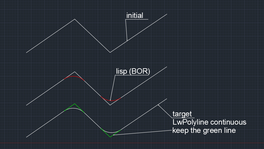

I am writing a lisp to create a circular arc for a pline according to a given radius R. I originally intended to "entmod bulge" with Get '(42 . x) at Param in list data lwpolyline; but things are not as simple as I thought.
So I went in another direction. Can someone help me complete the lisp I'm writing for the purpose as shown below. Sincerely thank you!

Lisp creates circular arcs with different optional radii at the pline vertices that I pick. My goal is to create a continuous pline and two blue vertex lines as shown.
"two blue green vertex lines as shown". Yes / No ?

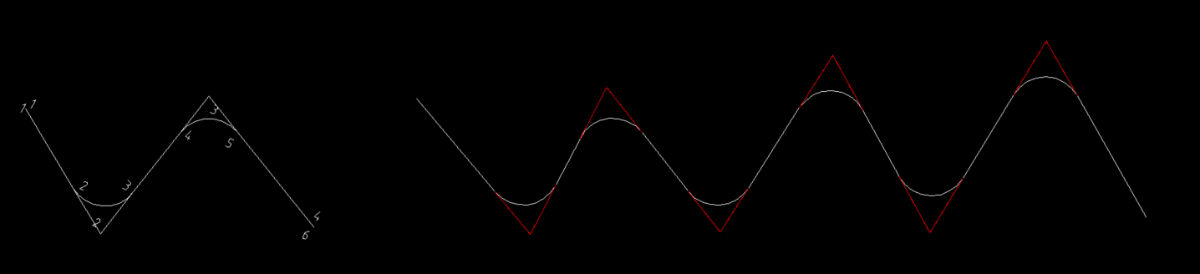

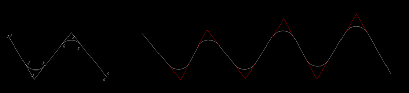

Just thinking get vertices before add radius. Pline = 4 points.
Add radius's Pline vertices now 6 points.
Should be able to do some form of join correct points, only problem I see is where two straights do not have a radius between.
