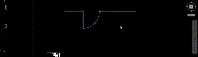

hello everybody
how can i set 2 point for insert block
for example , for draw a door ask 2 point  and can return by mouse like this gif
Edited by mohammadreza
I am using these 2 routines that are doing this stuff during creation...

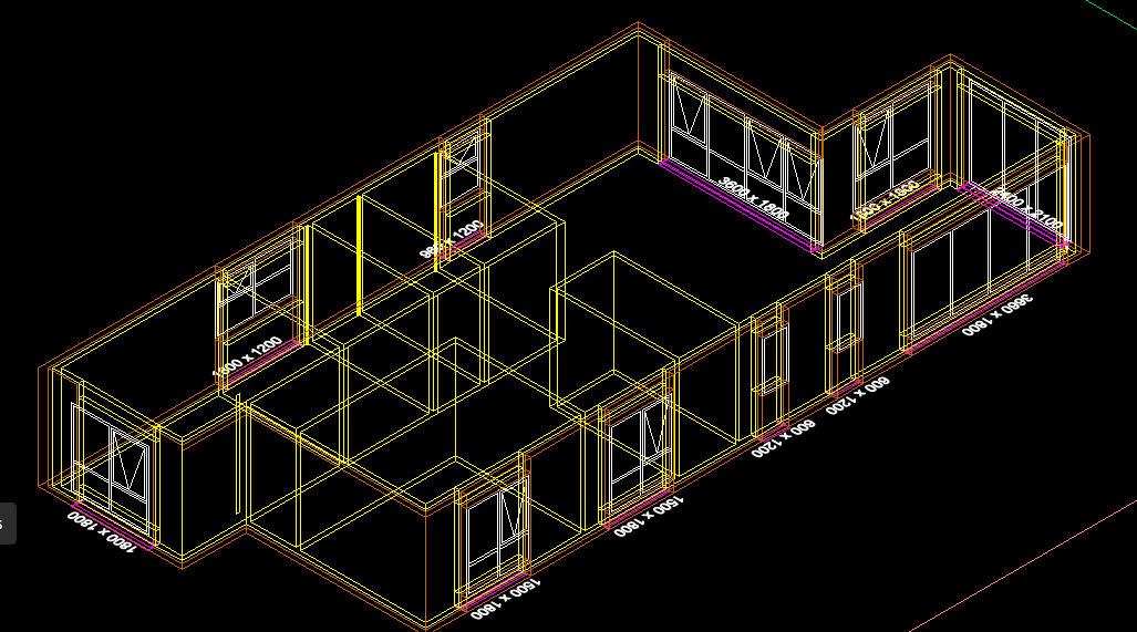

Similar approach but a big package yes a cost. Enter sizes and drawn. Doors need to be added plus roofs etc. Currently trying to convert to imperial. Yes asks for offsets from corner then width, in out, left or right swing.
  On 11/9/2023 at 5:01 PM, marko_ribar said:
And this is what I use for windows...
(defun c:ww ( / mid clockwise-p vl-position-fuzz osm p1 p2 ch di a1 a2 pp1 pp2 pp p311 p312 p321 p322 w p3 al ll gr aa pos ax k b ) ; *width* is global variable

hi
do you have that door(2d) lisp ?
like that i sent as gif ?
No, I don't have, but you can pull out from routines 4 quadrants from different orient angle and use (grread) position of cursor function inside (while) loop to scale block in X direction to 1 and -1 (meaning mirror) and the same with Y direction...
Edited by marko_ribar
Check out download section for newly added dd.lsp dw.lsp ww.lsp and blockflips.lsp ... Now dd, dw and ww are blocks with insertion point in the middle of p1 and p2...
[EDIT : It's not ab x and y scalefactors 1.0 and -1.0 like I was suspecting, but performing MIRROR command more times...]
Here is the code for flipping blocks :
