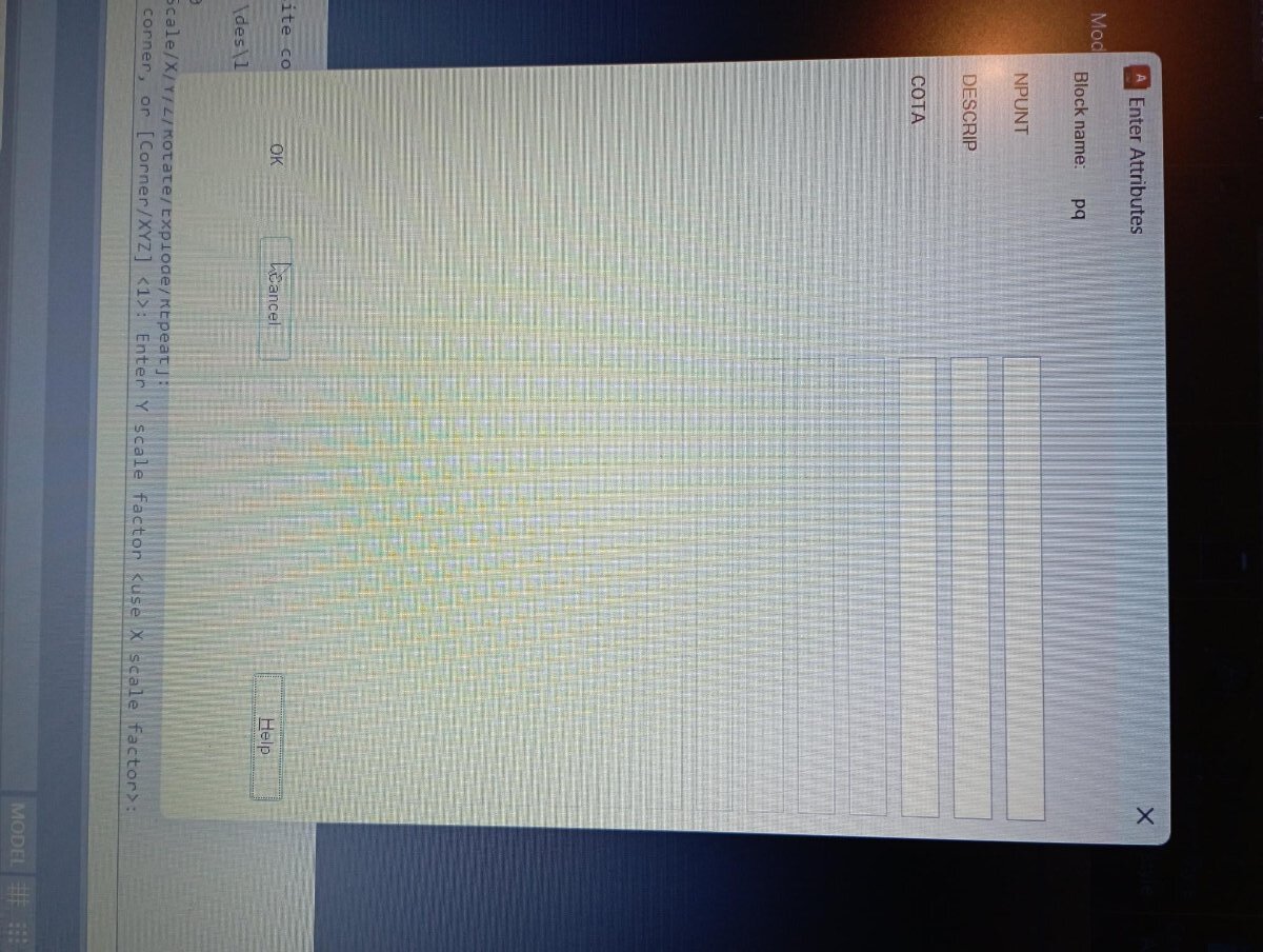

Hello Everyone,
I have a friend that uses a lisp routine for many years and it worked great up until version 2016. He now changed job and is using version 2023 and the lisp does not work right. It loads normal but at a certain point it sould get information from a TXT file that is solicited but it does not. It opens the Atribute window and askes to input all the data (as shown on the image I uploaded).
The Lisp should create a block/attribute composed of a point, the point number (npunt), description of point (descrip) and point elevation (cota).
It gets the coordinates for the point from the TXT file but not the rest of the information.
This id the lisp file (I have also uploaded it)-

Fist is "NPUNT" , then x coordinate, then y coordinate, then "COTA", then "DESCRIP" seperated with a space
Any advice?

Pt num bubble.lspHave a look at attached may be helpful about making the block pq.
Re read a line I use a  Lee-mac function.

("9001" "-40647.112" "191241.058" "86.771" "12") then just use the values in the list, (nth 0 lst) (nth 1 lst) and so on.
Also check Attreq variable it stops or allows attribute entry.

Thanks everyone, problem fixed, just had to set attdia to 0 then it runs great and set it back to 1 after
