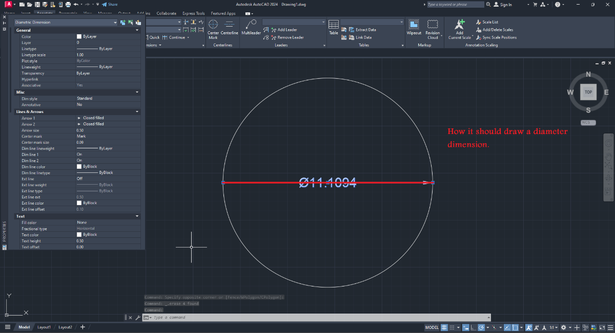

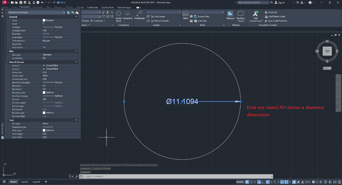

Gascon Posted November 5, 2023 Posted November 5, 2023 Hello everyone, I have started using Auto CAD for the first time ever today. I am trying to draw something. I am trying to create a diameter dimension for a circle. However, instead of creating a line that crosses the entire circle to signify diameter, my AutoCAD only creates half a line. This can be confusing for the person who will make my design as they might think that the radius of the circle is for example 3 instead of the diameter being 3. I have attached a screenshot. If you can advise how to fix this I would appreciate it. Quote

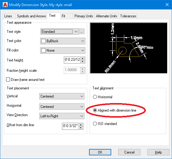

BIGAL Posted November 6, 2023 Posted November 6, 2023 Check your dimstyle, make sure the left and right extensions are ticked on. What does a Horizontal dim look like ? Quote
Gascon Posted November 6, 2023 Author Posted November 6, 2023 On 11/6/2023 at 7:06 AM, BIGAL said: Check your dimstyle, make sure the left and right extensions are ticked on. What does a Horizontal dim look like ? Expand I checked and they're on. If I use a diameter dim it will only draw half a line no matter where in the circle or at which direction I put it. I tried and could draw a full diameter line using aligned dim. Quote

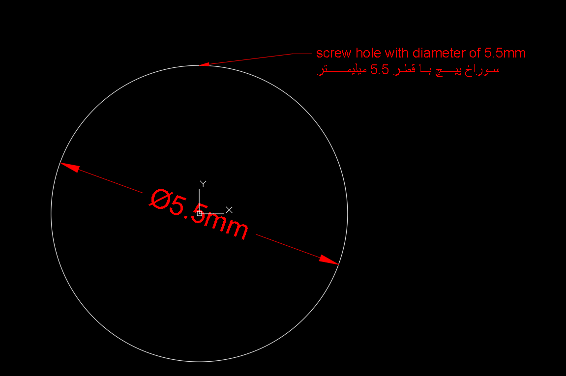

ReMark Posted November 6, 2023 Posted November 6, 2023 Type Diameter Dimension tool measures the diameter of an arc or circle. To create a Diameter dimension, click object 1 (i.e. - the circle) then click point 2 (on outside of circle) to create the dimension line. 1 Quote

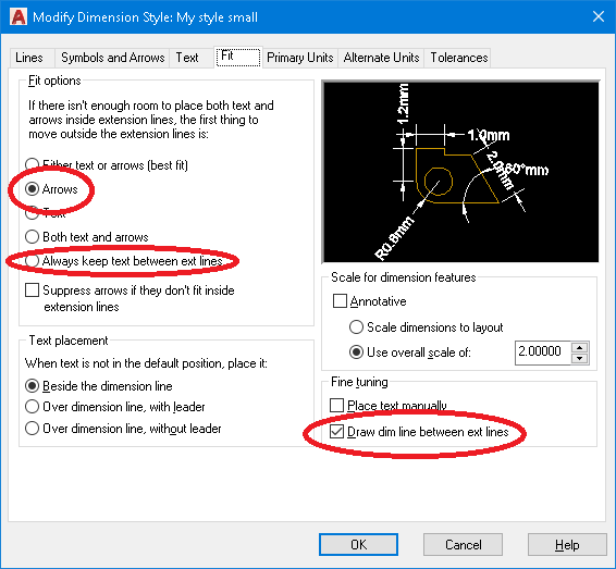

SLW210 Posted November 6, 2023 Posted November 6, 2023 You'll need to set that up in your Dimension Style. Check through the FIT category. See the "Draw dim line between ext lines" (DIMTOFL sysvar) and check it, test some of the other options as well. 1 Quote
Gascon Posted November 7, 2023 Author Posted November 7, 2023 Hi Someone on another forum advised me to use an aligned dim on the circle and add the pi symbol manually and I did that for now. I feel like this is a bug either on my system or in my app. I have attached my DWG file. Thanks. Plexiglass laser cut black - 1st Release Candidate.dwgFetching info... Quote
