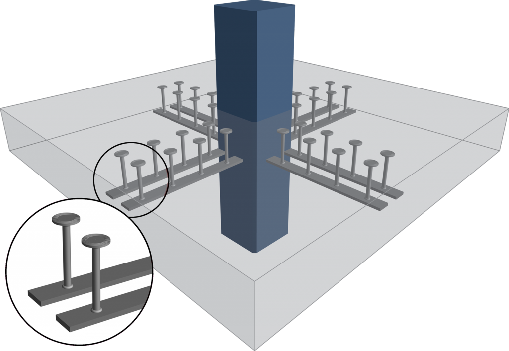

Not sure if you everyone is familiar what is stud rail is in the construction industry but they reinforce the load of concrete surrounding columns so they don't have to pour more concrete around the column to support the slabs. I have attached an image of an example below.
I'm looking to create an auto lisp to draw out stud rails in Auto Cad 2021. The parameters that are given are the rail width, rail length, number of studs per rail, stud diameter, stud spacing, and end spacing. If someone would be kind enough to point me in the right direction or set me up with a draft for an auto lisp that would be greatly appreciated.
