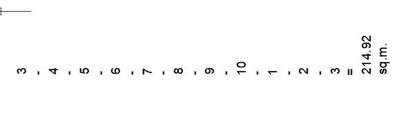

Any ideas?
Thanks
Edited by mhy3sx
I update the code. Now insert the text but the numbers are random and with wrong angle !!!
;(defun aH:getatt (blk tagn)
;(setq atts (vlax-invoke (vlax-ename->vla-object blk) 'getattributes))
;(foreach att atts
;(if (= (vla-get-tagstring att) tagn)
;(setq str (vla-get-textstring att))
;(princ)
(defun aH:getatt (blk tagn / atts str)
(foreach att atts

I update this line
      (command
        "_.mtext" (getvar 'viewctr) "_height" txtht "_width" 0 str ""
        "_.move" "_last" "" "@" pause
with
      (command
        "_.mtext" (getvar 'viewctr) "_height" txtht "_width" 100 str ""
The text is correct but vertical !!!! How to fix the code to insert the text correct? Any ideas?
Thanks
I fix it. I change the units settings !!!!
Thansk
