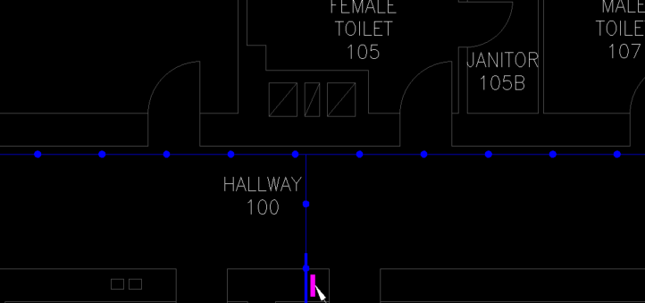

devries99 Posted October 28, 2023 Posted October 28, 2023 I am running autocad LT 2023. I have 500+ drawings with jhook runs which are a solid line with 5" diameter filled circles/dots spaced 50" apart. Would anybody be willing to make the .lin file and send it to me? Autocad LT doesn't hae express tools and I have searched hi and lo and cannot figure out a way to do it in Acad LT. Penny Quote

devries99 Posted October 29, 2023 Author Posted October 29, 2023 so I have worked with FENCELINE1 for over 6 hours. can you break down what each number represents. I was thinking 6.35 Length of line -2.54 gap cirlce -2.54 is another gap I tried to copy and rename your FENCELINE1 to JHOOK. I need the circle to be filled and 5" diameter and the space between them is 50" (4'-2" center to center) I bet I changed the numbers 50 times and could not make sense of what number control what. Quote

devries99 Posted October 31, 2023 Author Posted October 31, 2023 *JHOOK33,dots ----SWD----SWD----SWD----SWD----SWD----SWD-- A,8,-0.01,["o",STANDARD,S=2.5,R=0.0,X=-2.5,Y=-.9]-0.01,-5.08 Now if I could get the circles filled in. Quote
tollyrodgers Posted January 8, 2024 Posted January 8, 2024 Hi Pal, insert the unicode reference for the required symbol as I have below. The LT below is similar to the one you require. the "-3.2" is a space the "6.4" is the line length, units are in mm. R,X,Y is text orientation. *FIELDBUS_LT,CAT6 --- * --- * --- A,6.4,-3.2,["\U+25CF",Standard,S=3,R=0,X=-1.25,Y=-1.25],-3.2 Quote

tombu Posted March 2, 2024 Posted March 2, 2024 To include solid circles in a linetype reference a font that includes one. If your drawing has an Arial Text Style using the Arial font these linetypes work *ArialDOT,Dot . . . . . . . . . . . . . . . . . . . . . . . . A,0,-.125,["\U+2022",Arial,S=.05,Y=-.024],-.125 *ArialDOT2,Dot (.5x) ........................................ A,0,-.0625,["\U+2022",Arial,S=.05,Y=-.012],-.0625 *ArialDOTX2,Dot (2x) . . . . . . . . . . . . . . A,0,-.25,["\U+2022",Arial,S=.05,Y=-.048],-.25 If your drawing has an WINGDINGS Text Style using the WINGDINGS font these linetypes work *Big_Dot,Big Dots --- O --- O ---- O --- O -- A,3,-1,["l",WINGDINGS,S=1,Y=-0.45],-2 *Big_D-Dot,Big Dash Dot --- O --- O ---- O --- O -- S,.001,["_",Arial,S=2,X=0.09,Y=0.46],-2.2,["l",WINGDINGS,S=1,Y=-0.45],-3.2,["_",Arial,S=2,X=-1.55,Y=0.46] Quote
