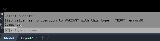

  On 9/26/2024 at 3:28 PM, marko_ribar said:
Also I've made few changes to original code... (added - (initget) before (getstring) which is changed to (getkword)) and (atof (strcat dir (cdr (assoc 1 data))))
Not tested though...
(Pozdrav, Saxlle...)

Thank you Marko. (Hvala ti, uradio si izmenu umesto mene. Pozdrav!)
  On 9/26/2024 at 3:08 PM, Saxlle said:
@Jojo
The problem is that you type a "r" to offset. You need to enter "+" or "-", or just pick a desire direction to offset line or polyline from command line (you will see a highlighted values "+" or "-").
Best regards.
Expand
Thank you Saxlle. It work awesome. much appreciated.
