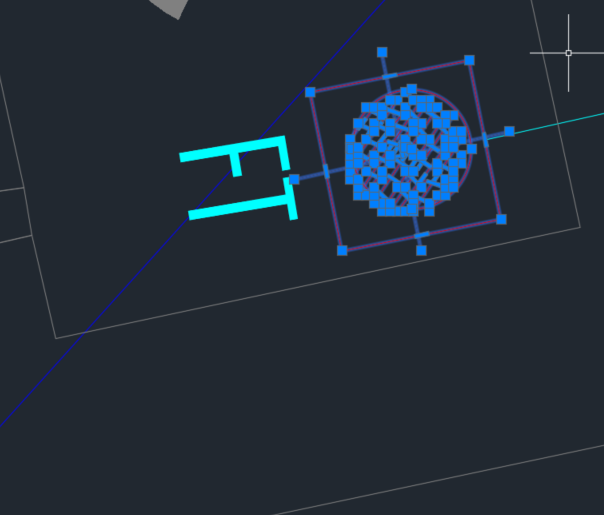

avatar550 Posted October 26, 2023 Share Posted October 26, 2023 I have a high-resolution PDF copy of an electrical tender project drawing made with AutoCAD. I converted the PDF to DWG, but the legends were distorted because of the conversion process. The legends are composed of multiple lines that look like drawings. Is there any way to select one legend and tell AutoCAD to find all similar legends and make each one of them a separate block or Legend that I can count and select? Note: I tried the Select Similar command and selected all similar objects, and I could find the similar legends, but the count was still based on the lines and not the legends." Quote Link to comment Share on other sites More sharing options...
SLW210 Posted October 26, 2023 Share Posted October 26, 2023 Can you post a before and after in .dwg and the original PDF? 1 Quote Link to comment Share on other sites More sharing options...

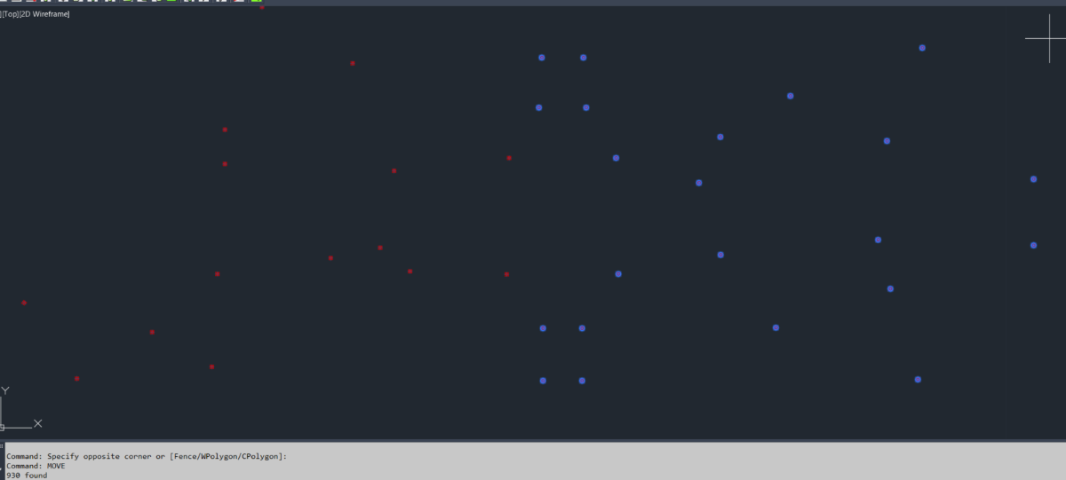

avatar550 Posted October 26, 2023 Author Share Posted October 26, 2023 I apologize, but I lack the authorization to distribute the project. However, I can provide a screenshot of the Floor Trap legend where you'll be able to observe the count (930), though there are approximately 73 unique ones. Additionally, if you're interested, I can furnish the legends in a separate DWG file. Quote Link to comment Share on other sites More sharing options...

Steven P Posted October 26, 2023 Share Posted October 26, 2023 So this is quite a basic counter: It will ask you to select an object in the group and then select the drawing area. The first selection sets the search criteria (ssget with a filter) - here searching for anything of the same entity type, on the same layer with the same colour (can add more filters later if needed). So if you select a circle on layer "PDF_Waste_Pipe" with a colour ByLayer it will return how many of these it finds... even if there are 2 or more in that group. Obviously it will work the best if your legend / blocks are on a unique layer - which in your sample they look like they are - and you pick an entity that only exists once in each group like a circle or rectangle. However looking quickly at your drawing I think this might cover what you are doing I think. I'll have a think to see if there is a more elegant way, I suspect that there is using the ssget function, crossing polylines and removing items from selection sets (defun c:sel ( / MyEnt EntLay EntType EntCol EntClosed MySS) (setq MyEnt (car (entsel "Select an Entity to count: "))) (if MyEnt (progn (princ "Thanks. Now select the drawing area to count") (setq EntLay (assoc 8 (entget MyEnt))) (setq EntType (assoc 0 (entget MyEnt))) (setq EntClosed (assoc 70 (entget MyEnt))) (setq EntCol (assoc 62 (entget MyEnt))) (setq SSList (list EntType EntLay )) (if (= EntClosed nil) () (setq SSList (cons EntClosed SSList ))) (if (= EntCol nil) (setq SSList (cons (cons 62 256) SSList ))) ; colour by layer (setq MySS (ssget SSList )) ) ; end progn (princ "Nothing selected") ) ; end if (princ (sslength MySS))(princ " blocks found") (princ) ) 1 Quote Link to comment Share on other sites More sharing options...

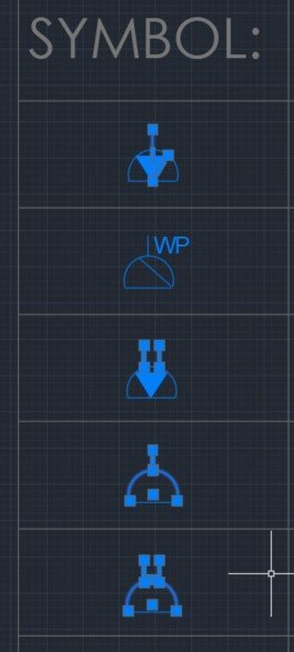

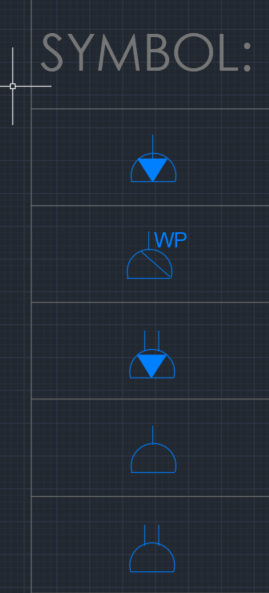

avatar550 Posted October 28, 2023 Author Share Posted October 28, 2023 It functions effectively alongside the Floor Trap Legend. However, in the attached screenshot, there's a similar legend. When I choose the triangle, it counts both the single and twin switches. Is it possible to incorporate a feature that allows for multiple object selection or filtering by line length, perhaps? As seen in the second image, you can observe the distinctions between the legends. Quote Link to comment Share on other sites More sharing options...
Steven P Posted October 31, 2023 Share Posted October 31, 2023 From what I made up above that will be a bit tricky though possible. I wonder, how much separation is there between the blocks in the drawing? Mostly, do any of them overlap? Like I mentioned above the selection works on a 'Selection set' which for a line is limited to quite a basic filter, start and end coordinates, layer, colour, line type. Other things such as line length can be inferred from the coordinates but you can't filter that. I've been to sleep since last week... and can't quite remember your sample drawing exactly. I am thinking that perhaps the selection set could be done in 2 parts. Something like this: Select an object in one of your legend blocks. This will let the LISP work out the entity type (circle etc), layer, colour for all the other similar symbols The user then selects a 'bounding box' enclosing all the symbols entities and the LISP can work out coordinates of that. Next stage is to select all the entities in that area (based on the criteria recorded from the first entity selected - layers etc), do a count of them Then... going back to what I did above, find all the similar entities in the drawing to the selection. These might be for example the 2 or 3 switch types also.... Now loop through this selection and apply the bounding box coordinates, modified to account for rotation and scaling to select all the object in an area around that entity (ssget with 'crossing polygon' filter) Finally with this selection you might be able to count all the entities in there, their type, calculate the lengths of lines and confirm that this is indeed a symbol that you want to count. There count, 1. And repeat.... The would rely however that the layer with the symbol on is reasonably uncluttered (if it was cluttered this might take a long time) So it is possible but does need a fair bit of fiddling about to make it work ! Could be a dead useful LISP to have, perhaps taking it further to replace the individual symbol lines with a block. Sadly not something I'll have time for this week, but with luck someone else might be able to help out and do something too 1 Quote Link to comment Share on other sites More sharing options...
