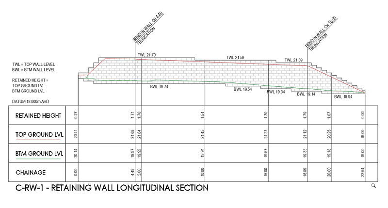

Hi All!
I'm after some help creating a routine that would draw a line between two other parallel polylines. as pictured below in red. I'm then hoping to turn this red line into a civil 3d profile using dynamo. I need each vertical line to have a slight x value (say 0.01m)
I've been playing around all afternoon with little luck.
Any starting points or tips would be great!

Generally our workflow is:
we will model walls in our corridor,
then create longsections,
then add in our top ground and bottom ground profiles (usually our design surface profiles at either side of the wall),
then we will manually draw our stepped profiles (TWL & BWL) onto the profile view to simulate a block work wall, which can be quite tedious on larger sites when we have complicated walls spanning hundreds of metres.
Hopefully this is clearer, otherwise I'll send over a sample DWG :)
Thanks!
Sorry I should have added, the process for drawing the TWL line is:
- stepping the profile at intervals of 200H x 400W, (rough dimensions of the standard besser block and mud)
- maintaining a min 50mm clearance above the top ground profile.
- generally do this by drawing a big grid of guidelines to help, which is then deleted afterwards
Same process for the BWL level however a 200mm Clearance below the bottom ground profile is used

I don't know much about civil works, but if you have red and green lines and want to draw the outline of a block, this link may be helpful.
https://forums.autodesk.com/t5/visual-lisp-autolisp-and-general/convert-splines-to-polylines-horizontal-and-vertical-line/m-p/8603503/highlight/true#M381260
SPC routine in this link can draw step lines along polylines.
you can specify the horizontal and vertical width.
Because this routine draws along a polyline
like a dot graphic on the selected line,
so you will need to do this after offsetting your red and green lines.
Oh wow this is almost perfect, hopefully I can make a few tweaks, thanks alot!

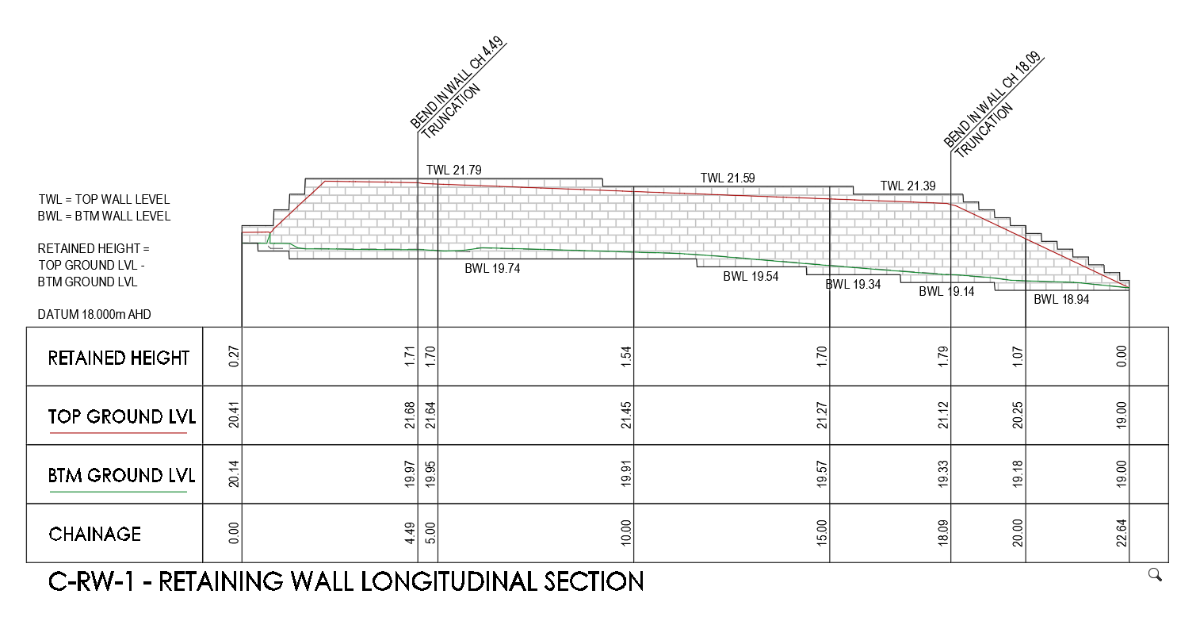

like this I think
or
if you are stacking blocks, an integer multiple of the height of the block will be required,
and above routine cannot take this into account.
If that's the condition,
I think there might be a way like this.
I don't know if this is shorter than the existing your method.
just for fun
That works very well!
I just need to add a small x value increase to each vertical step, so theyre not exactly vertical (civil 3d doesnt like vertical lines in profiles) of say 10mm?
Hopefully I can get it working, thanks for pointing me to that thread!
